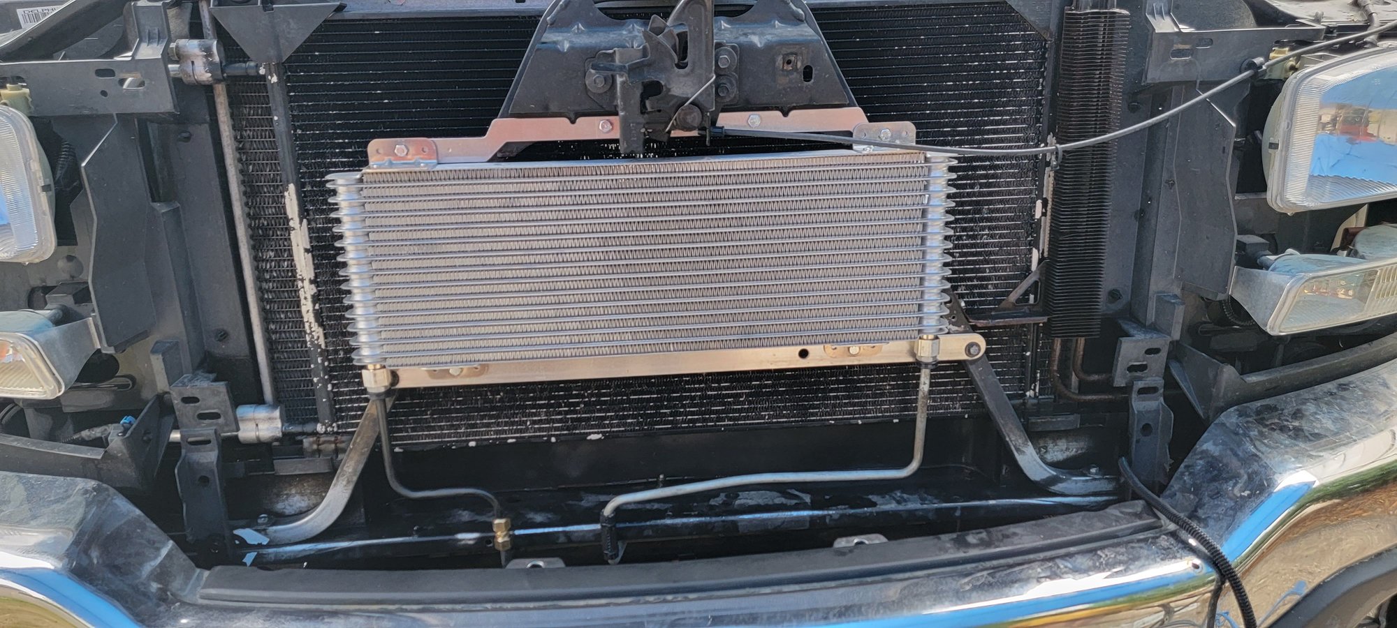

The brackets and fittings provided worked out great! Thanks for making this.

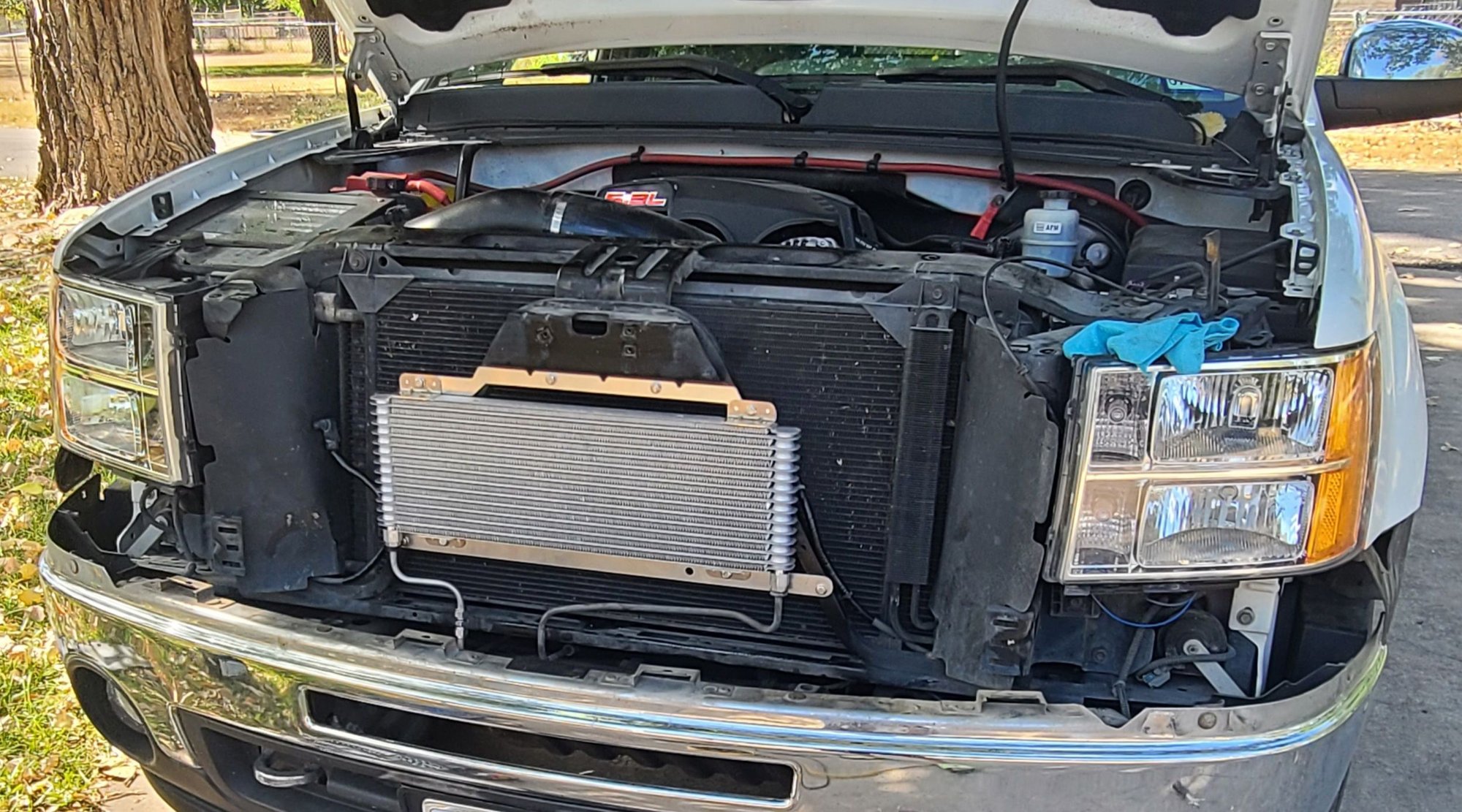

I installed on a 2010 gmc sierra. I cut the lower support bracket off and grinded the weld spot flat and repainted. Then I realized how am I going to mount the grill bracket back on without the 2 mounting holes on the lower support. Fix was using the 2 out of 4 heavy sheet metal screws from the cooler install kit with some larger washer I had laying around. Used stainless hardware for the rest and stainless superlok compression fitting. Rerouted the temp and hood latch sensor no problem. Temp sensor went onto the passenger side air baffle. Small hole drilled into it and pushed it in. Took about 3-4 hours with my OCD. Came out pretty well. Thank you for the excellent brackets.

Wow that's hot. My truck is tuned and shifts harder and mine did not get above 190, but I also wasn't towing and I'm here in Fort hood. When it was complete I added a little over a quart of fluid. I recommend you do a full system flush of the dex 6 and replace filter after installing the new cooler. Dex 6 does not like to get above 170-180. What's funny even the manual stated operating temp is 150-170. After install my fluid doesn't get above 160 while driving. After sending funds it was about 5-7 days before I got a tracking number. Then a few more days after that. I don't have the exact timeline but my guesstimate from payment to delivery was around 8-12 days. Order the cooler from Oregon performance. They ship it better and it's the updated cooler in the Dana/spicer box. They remove the hardware and place it on the side in shipping so it doesn't damage the cooler.
