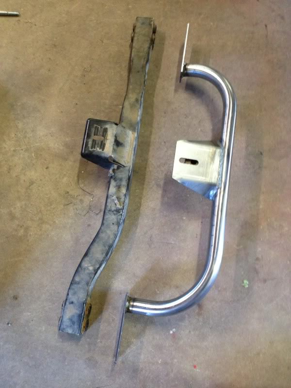

The 99-00 2wd crossmembers were the smaller square tubing ones and not near as big as these. These may still work in place though. The mount needs to be moved back 6 1/4" from 60E to 80E

99-Early 2000 crossmember

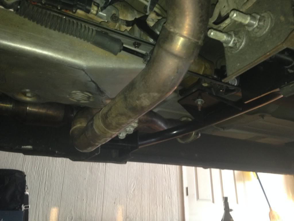

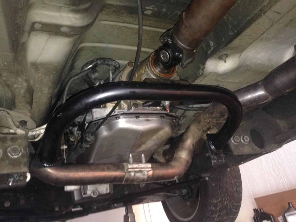

Installed pics

Sweet thanks for posting!!
