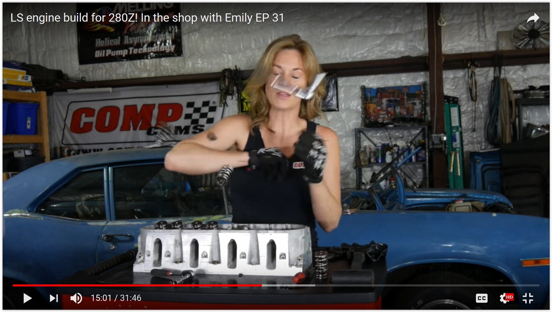

There are lots of youtube videos showing the procedure it's pretty easy and the basic spring tool is cheap.
My tip is to wear eye protection...

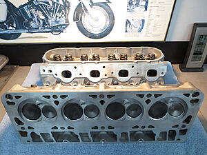

I'd also replace the valve seals while you're in there. The intakes and exhausts are different so don't over look that.
These are my old LQ9 heads that I hand lapped in the valves with valve compound and a valve suction cup. A lot of people use a drill at low speed for faster results instead of the cup.
