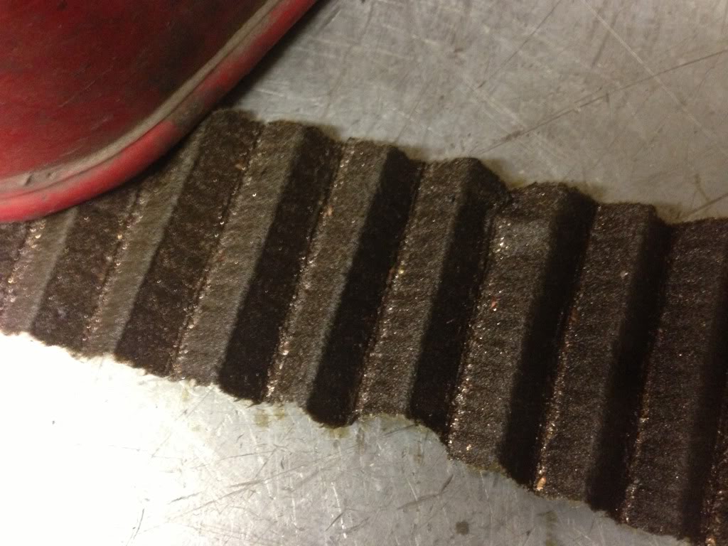

Did you check it with a manual gauge? and can you post pics of the filter? Here was my filter when both my main and rod bearing went to ****:

Old Aug 20, 2014 | 06:10 PM
TURBHOE's Avatar
12 Second Truck Club
Joined: Nov 2004
Posts: 6,318
From: Jacksonville FL.
No I've been painting my wife's car and DDing the hoe. Being that it's broke I have to make a mad dash to get her car put back together so I can drive it. I'll get to the hoe this weekend. This thing is a pain in my ***. But it's so freaking fun to drive. I feel like a kid at Christmas every morning that I drive it. It's been that way for like 6 years now yet it never gets old.
My filter looks close to the one in the pic. Wtf causes this? Running too low of rpm locked? My settings for the Tcc are stock which can go down to 1000 rpm locked up. It just tugs along.

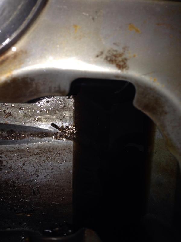

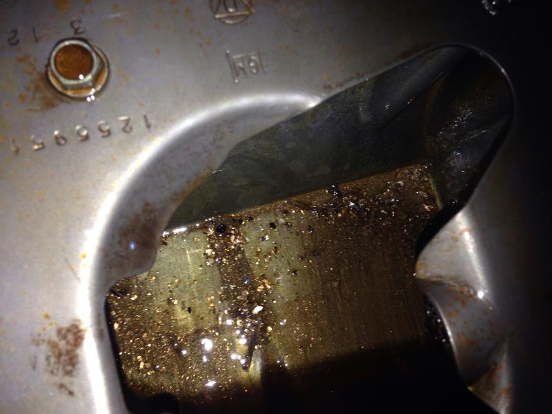

What are the cam bearings made of? My oil pan looks like a episode of gold diggers.
Old Aug 23, 2014 | 12:17 PM
TURBHOE's Avatar
Joined: Nov 2004
Posts: 6,318

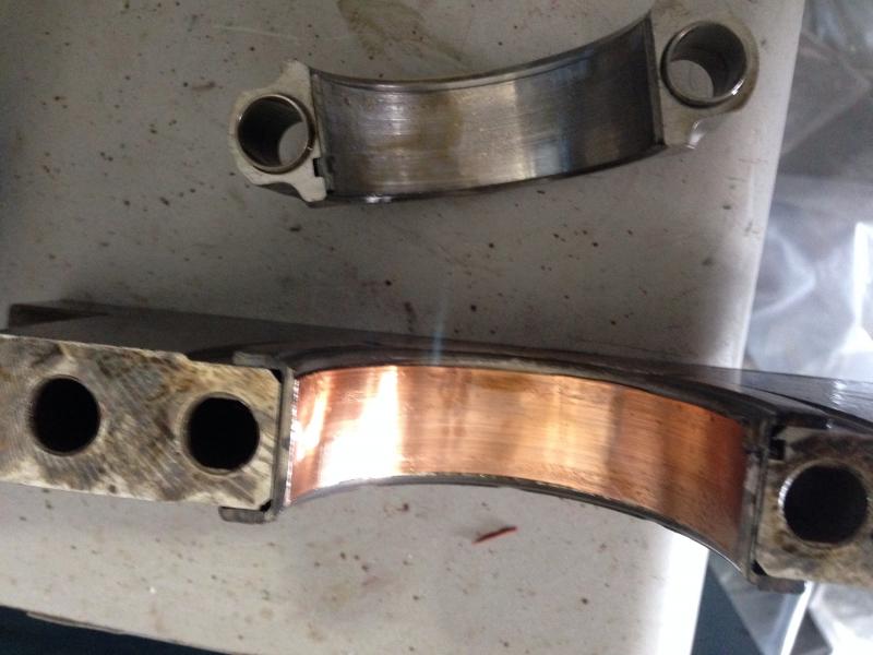

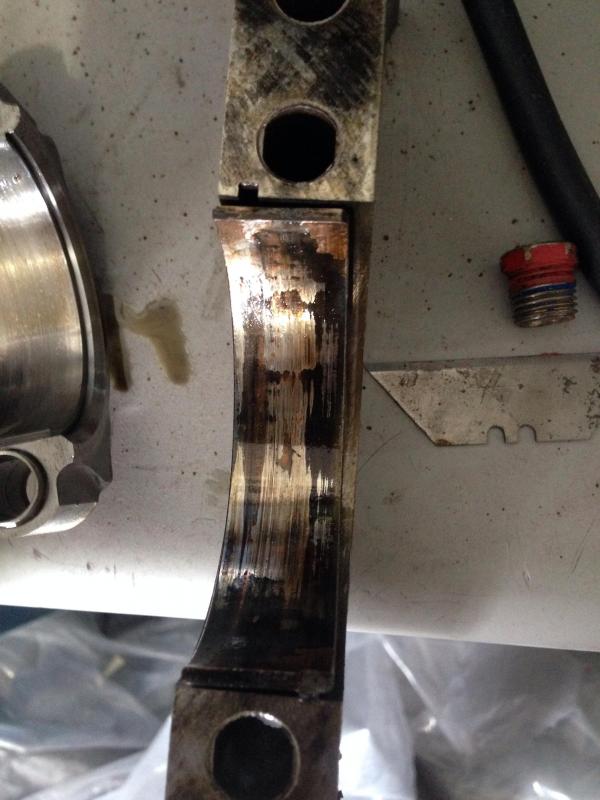

Ok mains are shot. No silver left in them at all. Rods look good though.

Old Aug 23, 2014 | 01:11 PM
TurboBerserker's Avatar
I AM A MOTHERF*CKER
Joined: Aug 2004
Posts: 7,132
Check the cam bearings too now that you've driven it with low oil pressure
Old Aug 23, 2014 | 08:23 PM
TURBHOE's Avatar
Joined: Nov 2004
Posts: 6,318
Size:  50.4 KBName:  image_zpsd87c6438.jpg
Old Aug 23, 2014 | 08:24 PM
TURBHOE's Avatar
Joined: Nov 2004
Posts: 6,318
The edges seem to be more worn.
