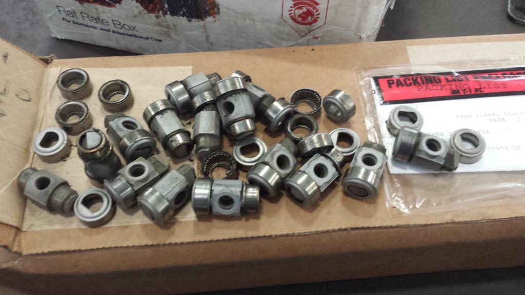

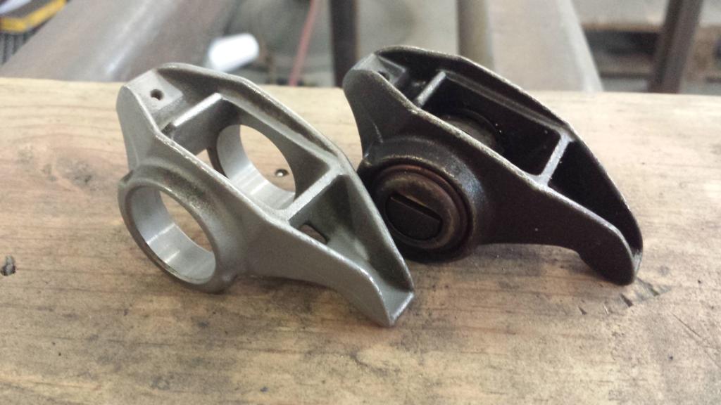

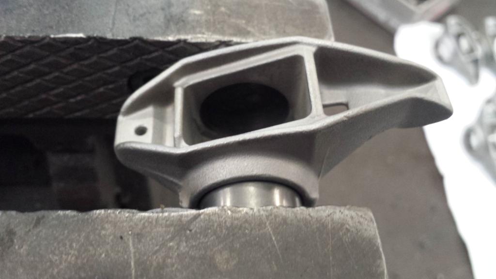

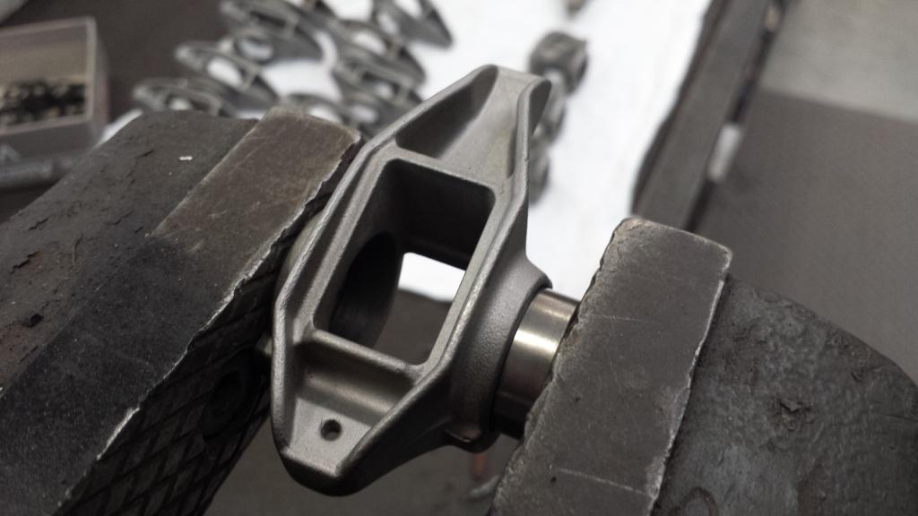

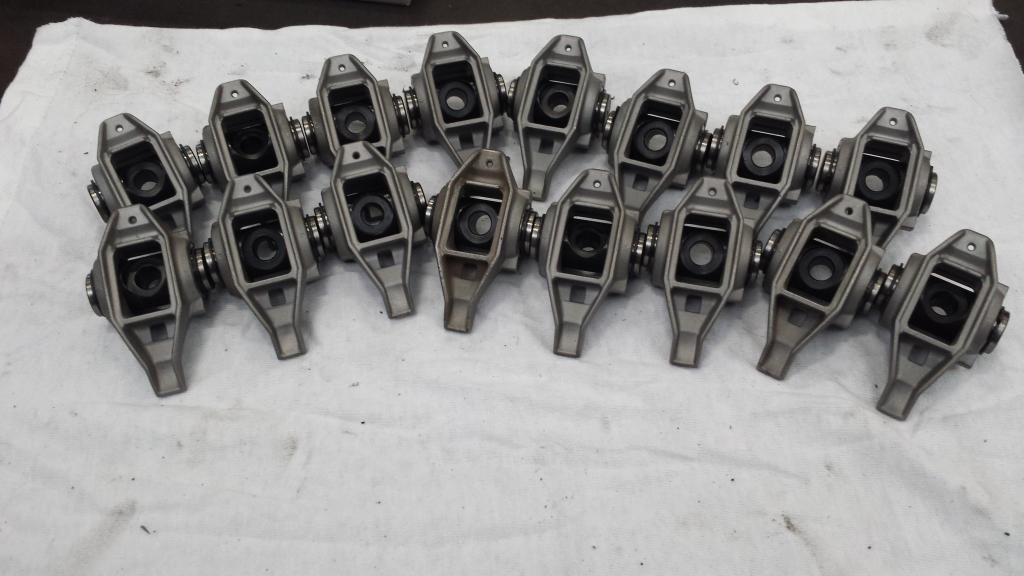

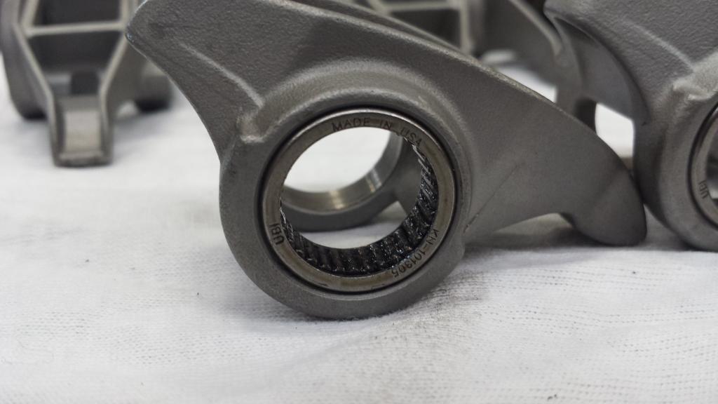

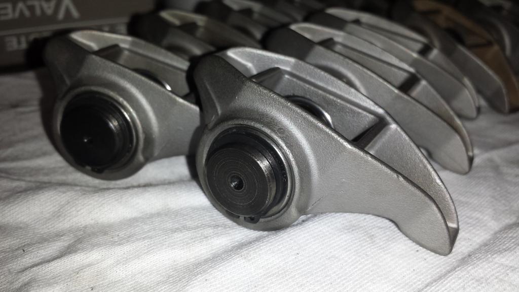

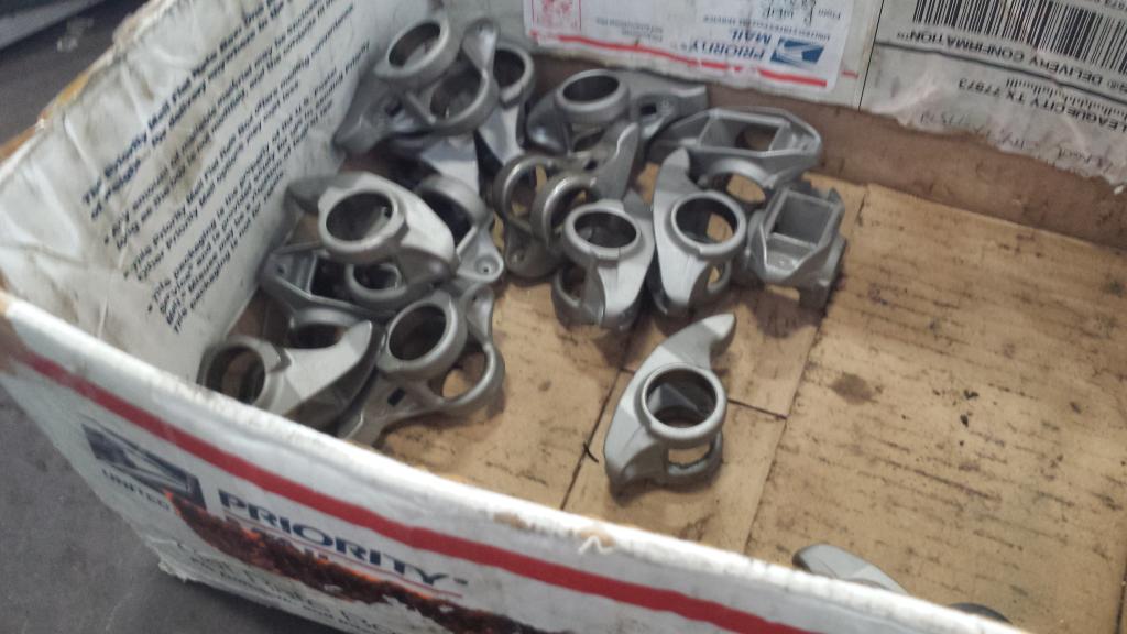

I had a L92 rocker fail and it ended up putting needle bearings all over the place. Here's an upgrade and a few pictures on how it's done using the Comp cams trunnion kit. Old rockers were sand blasted and then cleaned with varsol. A bench vise works great.

Wow, they turned out great. Did you sandblast the foot of the rocker too? I'm just wondering if it would cause premature wear on the tip of the valve.
Old Nov 4, 2014 | 12:26 PM
Tootall's Avatar
iTrader: (79)
Joined: Jun 2002
Posts: 5,175
From: League City, Tx
No I didn't, I just tapped them off

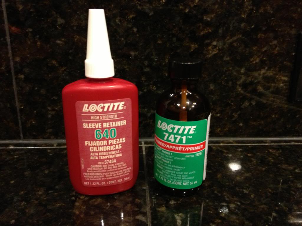

I also did the trunion upgrade, but saw a few people were having the bearings walk out and snap rings breaking at the time (about a year ago). So I got some loctite 640 sleeve retainer and put that on before pressing the bearings in. It adds 3000 psi of shear strength to the press, so I feel better about it. Not saying they're still having this issue, just something I saw then. I also used primer before the sleeve retainer for added peace of mind. Here is what I used:Name:  IMG_1615JPG2_zps61e60e02.jpg
