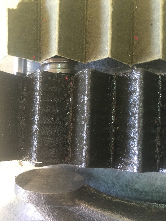

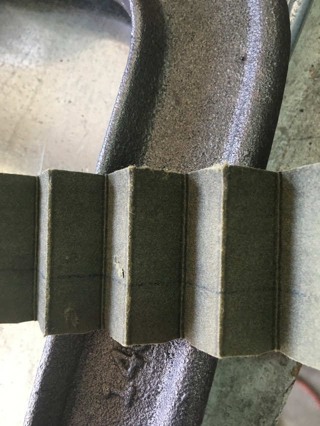

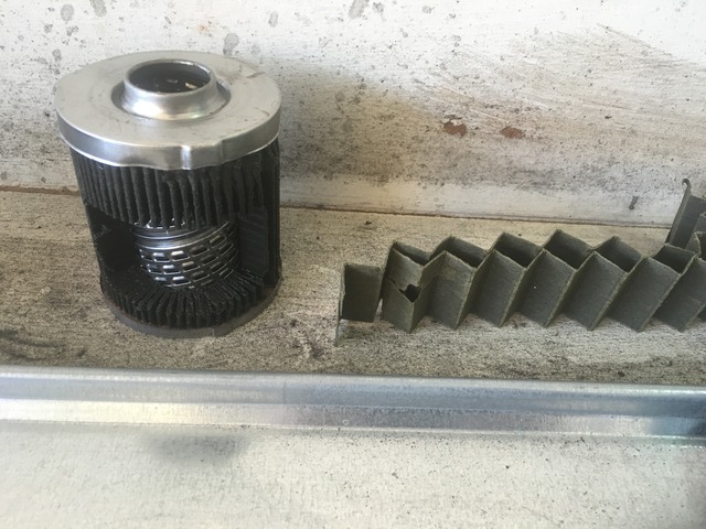

Here's some pics of the oil filter at first oil change.
I put a little more than 200mi on the engine so far and I can feel it loosening up quite a bit. Definitely starting to feel stronger. I can't wait for the tune to happen. Under wide open throttle from first to second gear shift at 5200rpm is hardly thrilling but it is keeping me from beating on it too hard.
I'm using a K&N HP-2006 filter. Looks a little grimey to me. Hardly any iron content as I checked with a magnet. All the little sparkle bits seem to be aluminum as they weren't attracted to the magnet. I used coated bearings so I'm hoping that stuff isn't the coating and bearing material.
The method I used was to take the filter media and wrap it in a Scott towel and squeeze it in a vice to get all the oil out it to make it easier to see the particles. That's the visual difference between the black media vs the greenish media.
Other than being a little cleaner during assembly I feel it looks ok. I think it has too many shiny sparkle bits for my liking but I've never built an engine from scratch before so I'm not sure if that is normal. I'm waiting to compare it to the next oil change after the Dyno session. Hopefully there is less shiny bits. The engine has been in assembly stages for nearly 2yrs so I'm guessing the dust and dirt from Arizona may be to blame for some of that stuff too.
