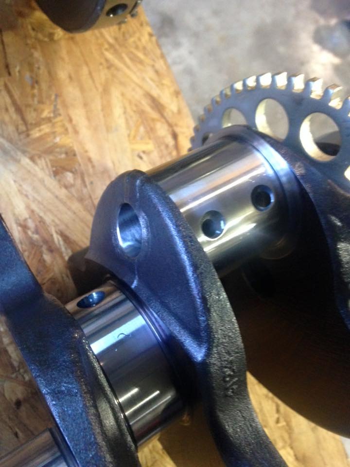

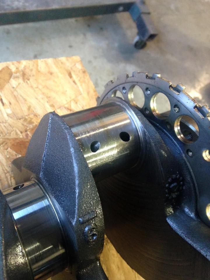

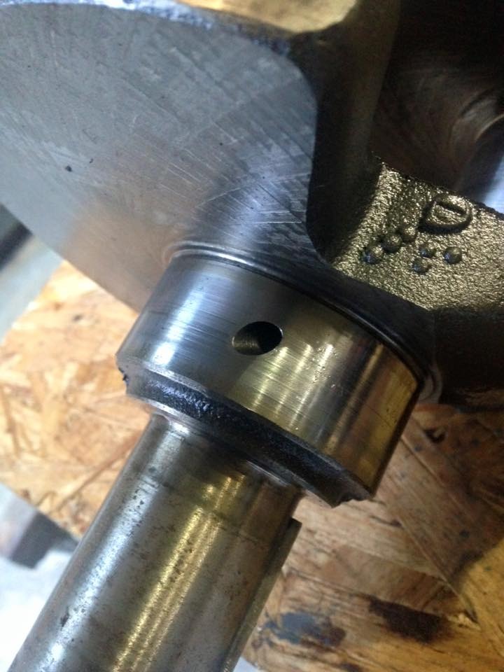

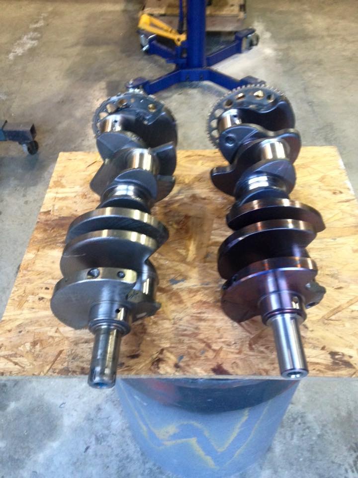

if anyone is wondering what they look like heres some pictures this thing is a nice piece of eye candy
stock crank on left forged LSA on right
stock crank main journal
LSA crank main journal
Stock crank rod journal
LSA crank rod journal
