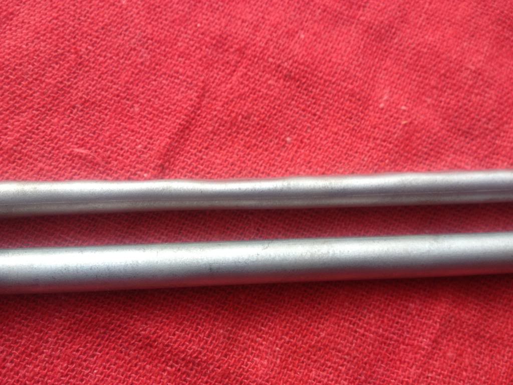

I used a 5/16 brake line that come in 5' lengths and cost about $6. I cut one end 20 1/4 and the other 19 3/4 then sanded the ends.
I tested this on a scrap piece but I hammered one piece from one end to the other on the cement to make it a D shape and it worked.
