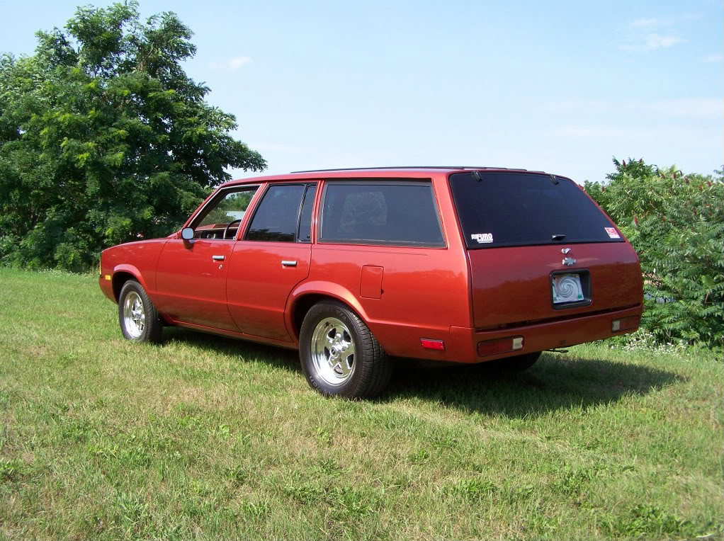

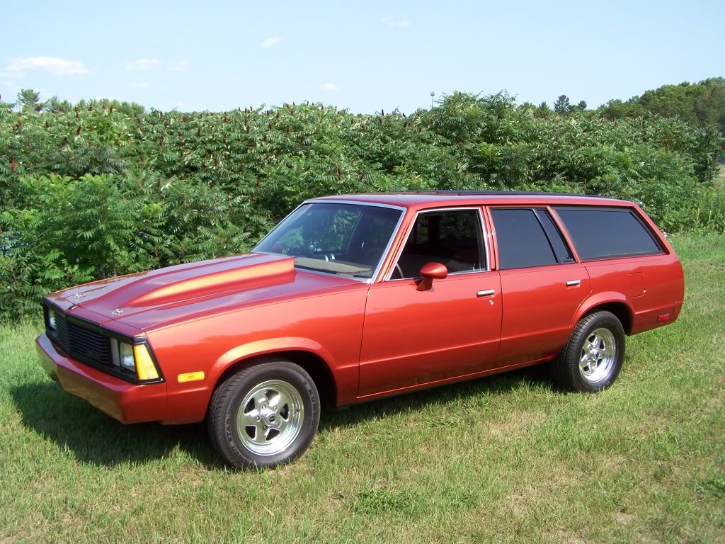

Nice setup lsxmalibu...do you have any more pics of the Malibu?

thanks....

NICE RIDE !!! any more engine shots ?
