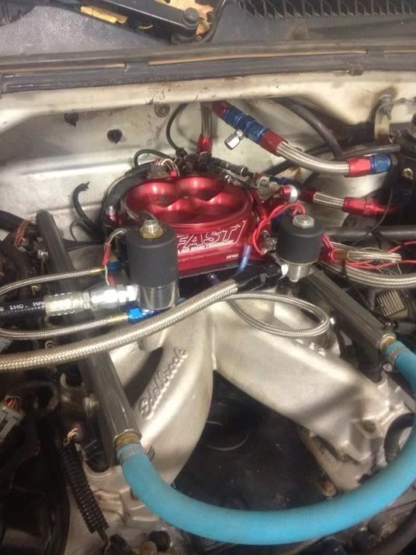

Go with a Vic jr.. My 370 made 455 thru a 4l80 with the converter unlocked with a Vic jr, stock l92 heads, and 4150 4 barrel throttle body. They are far cheaper than a fast intake. Then if you go to spray it, you have a lot better choices for cheap nitrous plates that have better nitrous distribution and make more power than regular plates.
pics of said setup??
I had thought about that route b4. And I was told it was not worth it, due to heat soak from those type manifolds.
I would think that TQ will still be there for a Tahoe? or is the Truck intake better suited.

Considering I still pull a boat and it never drops out of overdrive going up hills and passing cars, it has plenty of torque. Cut a 1.59 60' in my extended cab.
