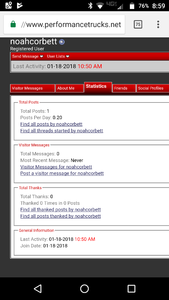

One post and he waited an hour for an answer, hasn't been back since.

Ha, ha, ha. Not at all. It's just that there are so many people that come to this website, post a question, and never even check back to see the answers. And your question was typical of such people.
