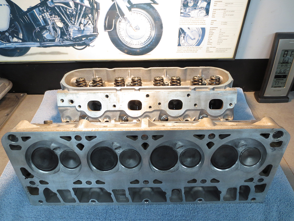

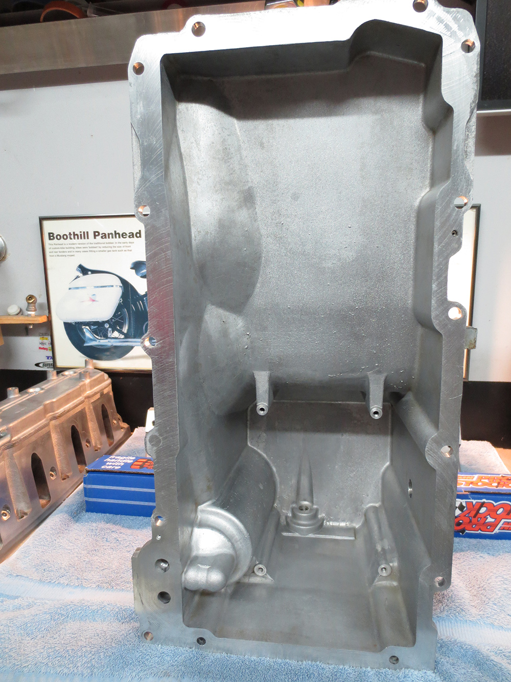

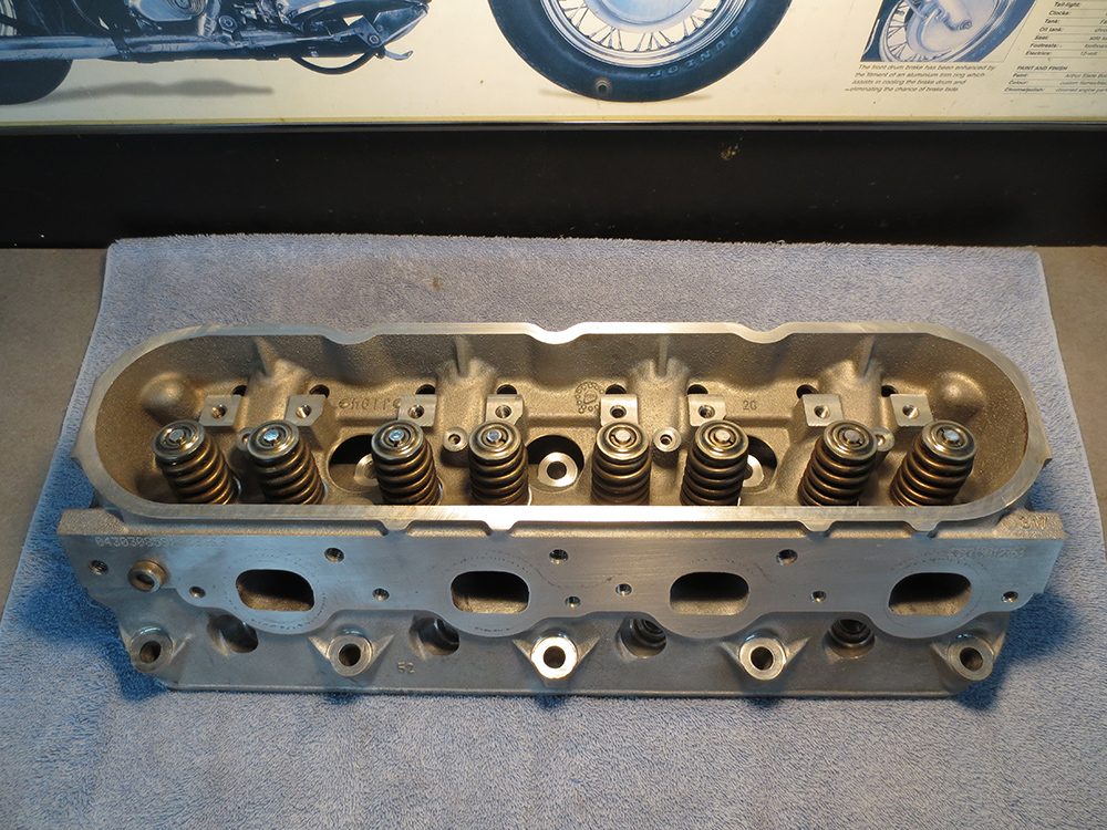

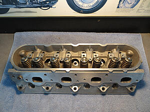

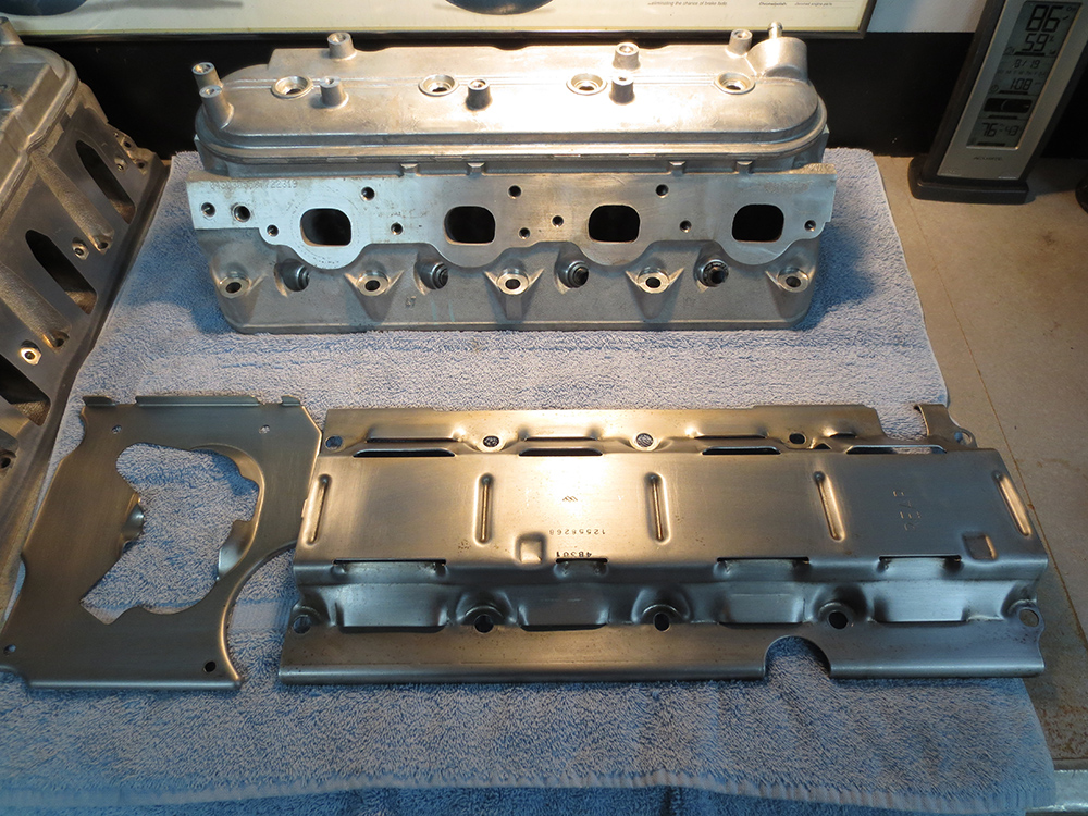

I used Greased Lightning Degreaser, brushes and got soaked blasting with my pressure washer. I did this for all my greasy parts for the LQ9 rebuild. If you have hydrophobia this method may not be for you

Man it's amazing how clean you got those with a little elbow grease
