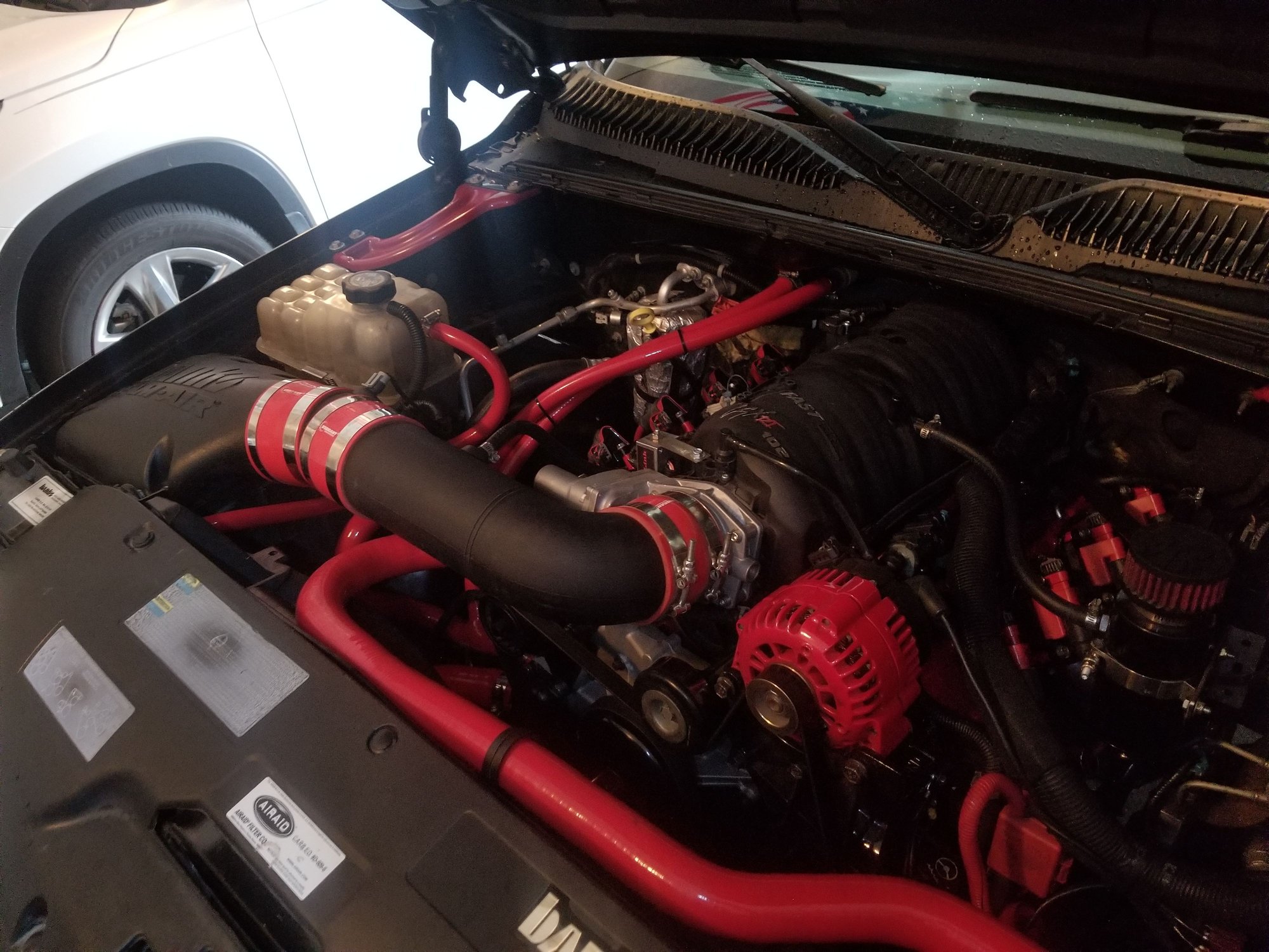

Originally Posted by darkirish63
Yep...I run a Stroker in my rig as well. Passenger side vacuum draws from the intake tube and the PCV side has the fixed orifice valve going into a Mighty Mouse catch can to the LSXRT intake. Maybe a couple ounces every 3k oil change.
I get about 5 to 6 ounces evey month. Other than the LS6 Valley Cover, we have the same setup. Maybe I should block off one of them?
Chad

That’s not a cam problem that’s a PCV Problem that needs addressed. You must have way too much air volume being moved by the pcv. Restrict it.
Yep...I run a Stroker in my rig and I run the passenger side vacuum from the intake tube and the drivers side PCV through a fixed orifice valve to a Mighty Mouse catch can to the LSXRT intake and I don't get more than a couple ounces every 3k oil change. Pic attached.
