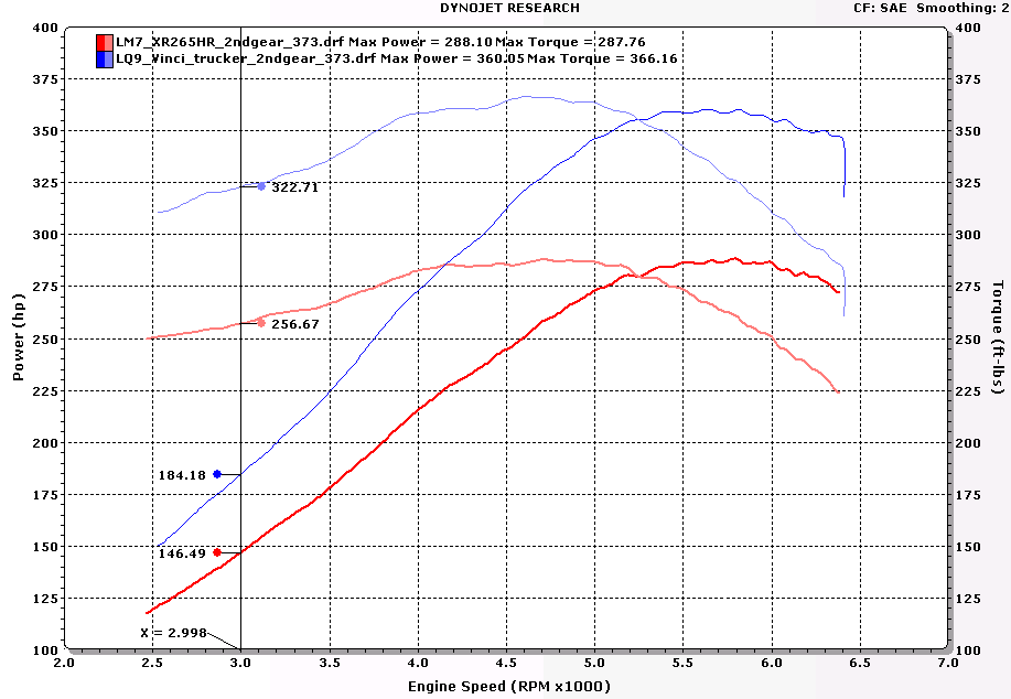

I think a stall would be more fun off road. If you decide to keep the stock stall than the 212/218 would be perfect, anything larger really needs a stall. Were those dynos with manifolds and large wheels/tire? They seem kind of low for a bolt on/cam 5.3L and 6.0L with stockish size wheels
