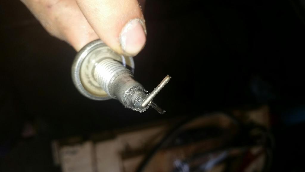

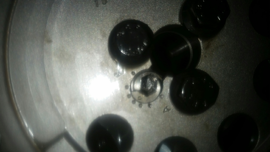

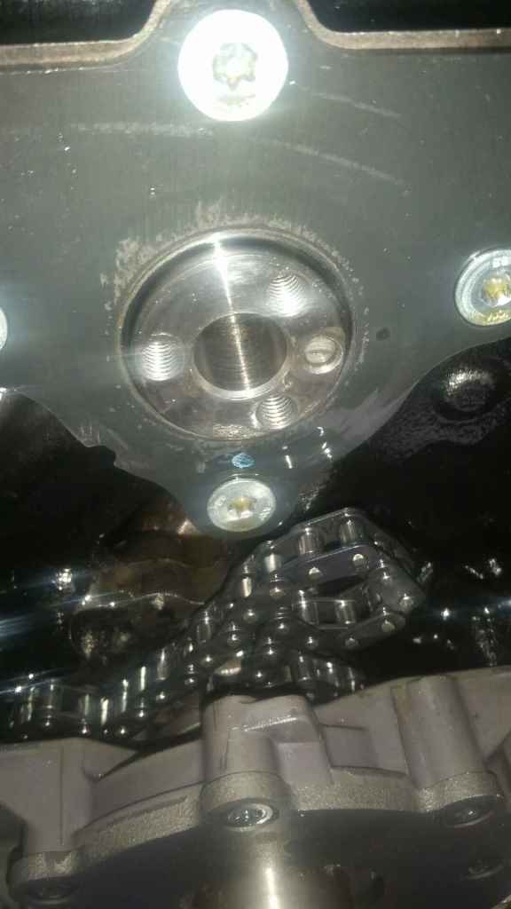

Well the carnage is in lol. Cam gear loosened taking out the dowel on the cam and mushrooming q lifter as well as wiping another out. The hex adjust shattered and took out the dowel. Drained the oil to find a **** ton of shavings and two needles from the bearings. So it's either take the chance and fish out the shroomed lifter or pull the engine and do things as I wanted in the first place

How'd that happen? Did you loctite it in and torque to spec?

Loctited to spec but somehow loosened up. No ptv issues either everything torqued to spec etc. Unless somehow I had a defective lifter. Reguardless it's a mess

FYI depending on the balancer used some have had the same issue as you, the harmonics from some of the balancers causes the chains to flex alot and put additional stress on the cam sprocket and causes the bolts to break or back out
Kurt urban spoke about this several yrs ago on Ls1tech and YB
the ASP pulleys are known for this

Hit the nail righr on the head...I have an asp on it atm
