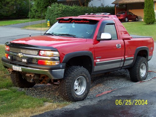

I don't know nothing about choosing a cam, I called up comp cams told them what I had an that's tha cam they suggested. The second bigger cam is from a lingenfelter engine build up from car craft magazine. Right now i'm staying natural with mabey 100 shot of nitrous just for fun. Next year after the 02-05 caddy conversion is done, I plan on putting a turbo or a supercharger. So if at all possible, I want to set myself up for the later. The truck is a single cab. It is my daily driver weekend strip/mud bog toy.
