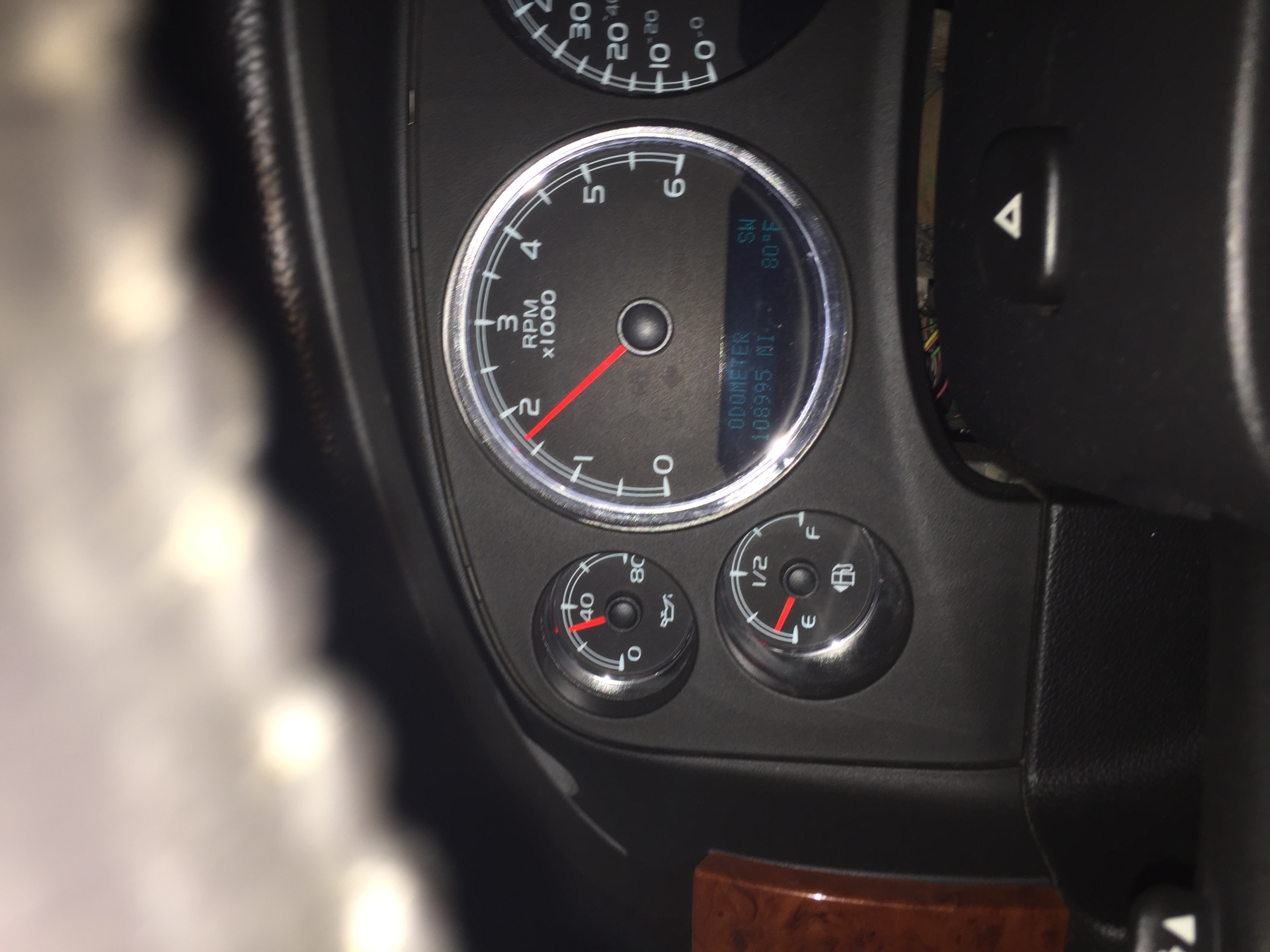

I just put a LSX 376 B-15 in my '11 GMC Sierra. I'm running the oil pump that the LSX engine came with. I am running the oil pick up tube that came with my stock 6.2 in the truck. It had a orange O-ring so I got a brand new orange O-ring and placed it on the oil pick up tube. My oil pressure at ideal is probably around 25 psi and at WOT it still never makes it quite to 40 psi. My question is do I have an issue? Currently I still have the pressure relief valve in my oil pan and I've read that you can get some more PSI by plugging that valve off, but why did my stock 6.2 w/ relief valve idle around 35-40 and now this brand new LSX idles at 25 psi?? Just wondering if anyone has ever dealt with this before.
Thanks for any and all help or advice.
Josh

Different bearing clearances and oil temps could bring pressure down.
25psi isn't bad, still plenty of pressure for a motor at idle. I'd remove the relief because you really don't need it.

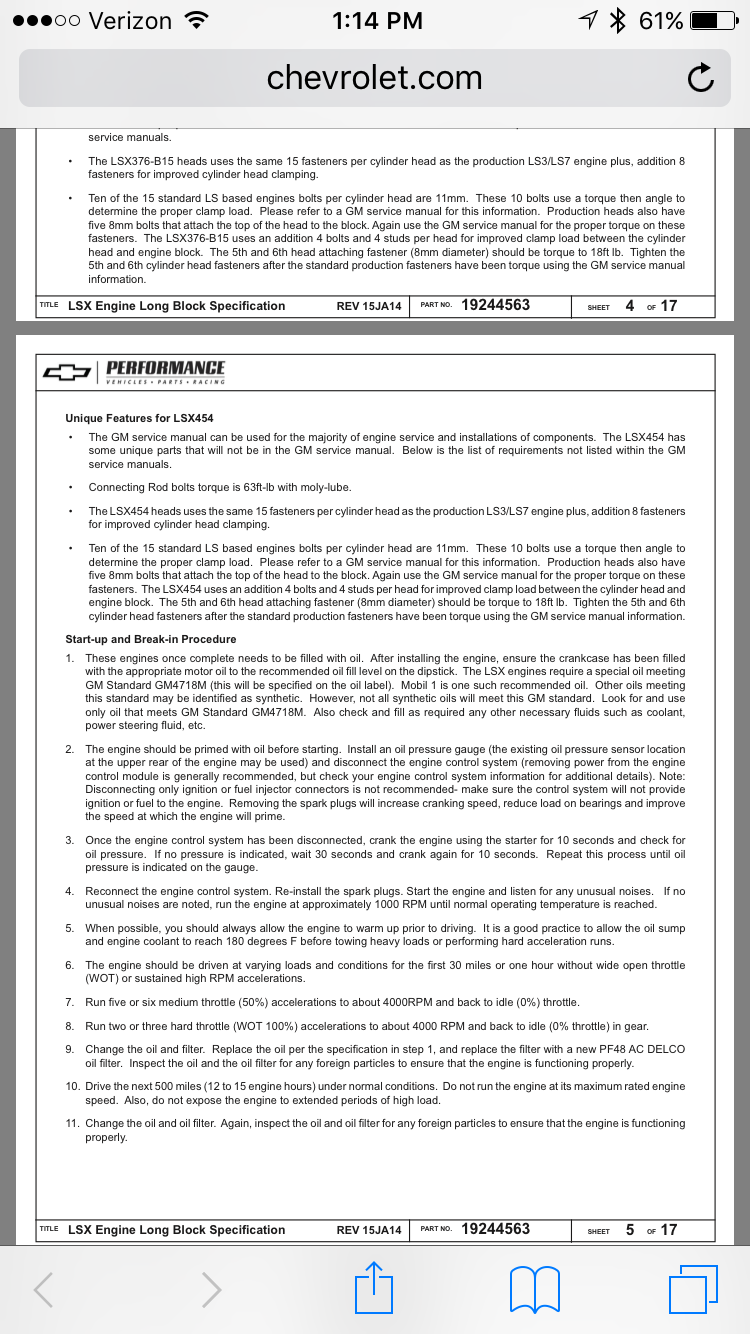

I attached a picture of the break in procedure per GM. They do not state the specific weight oil they just state that it has to meet the GM4718M. Mobil 1 is an oil that meets that standard. I can only assume that the standard oil for LS3's would be the best oil so I'm running 5W-30 mobile 1 w/ some Lucas break in oil additive.
Cold start up PSI is really close to 40 if not at 40 PSI.
Yeah I'm going to plug it but it's gonna be a pain In the butt!! Sense my truck is a 4wd I will either have to pull the engine again or drop the front diff - which is what I'm probably going to do. It's possible that it's sticking but it wasn't when I pulled it out and I cleaned it off really well before putting it back in. Yeah that is the correct thread call out. Dorman makes a drain plug that I'm going to pick up and put in the relief valves place.
I just wonder if I should put a high flow oil pump in while I'm there?
