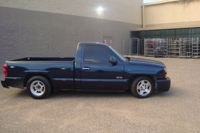

Thats mine^
And yeah turbo is expensive, My cousin did 10.5_ @ ??? With turbo 5.3 stock bottom end
He said it was about a 7k when it was all done
And even tho its better to have an N/A setup or a nitrous set up,
I would like to run both.. And I mostly race in Mexico ( If you know what I mean ) So I want a top end setup, But well thats after I make up my mind on what to do lol
I love the turbo sound but In the research i've done 370ci is best for turbo.. But doing an estimate [IMO] thats around a 8-10k build.. and building a 408 or 415ci with a 200 shot i'll probably have the same hp/traxk times.. And I doubt i'll spend more thsn 6k? Or will I? lol
