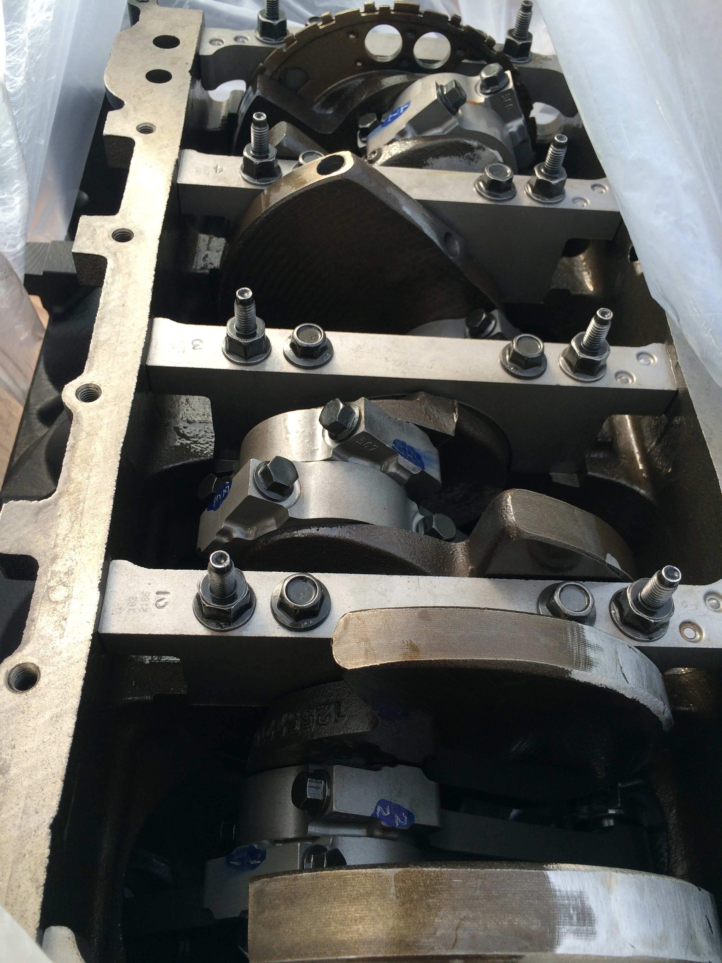

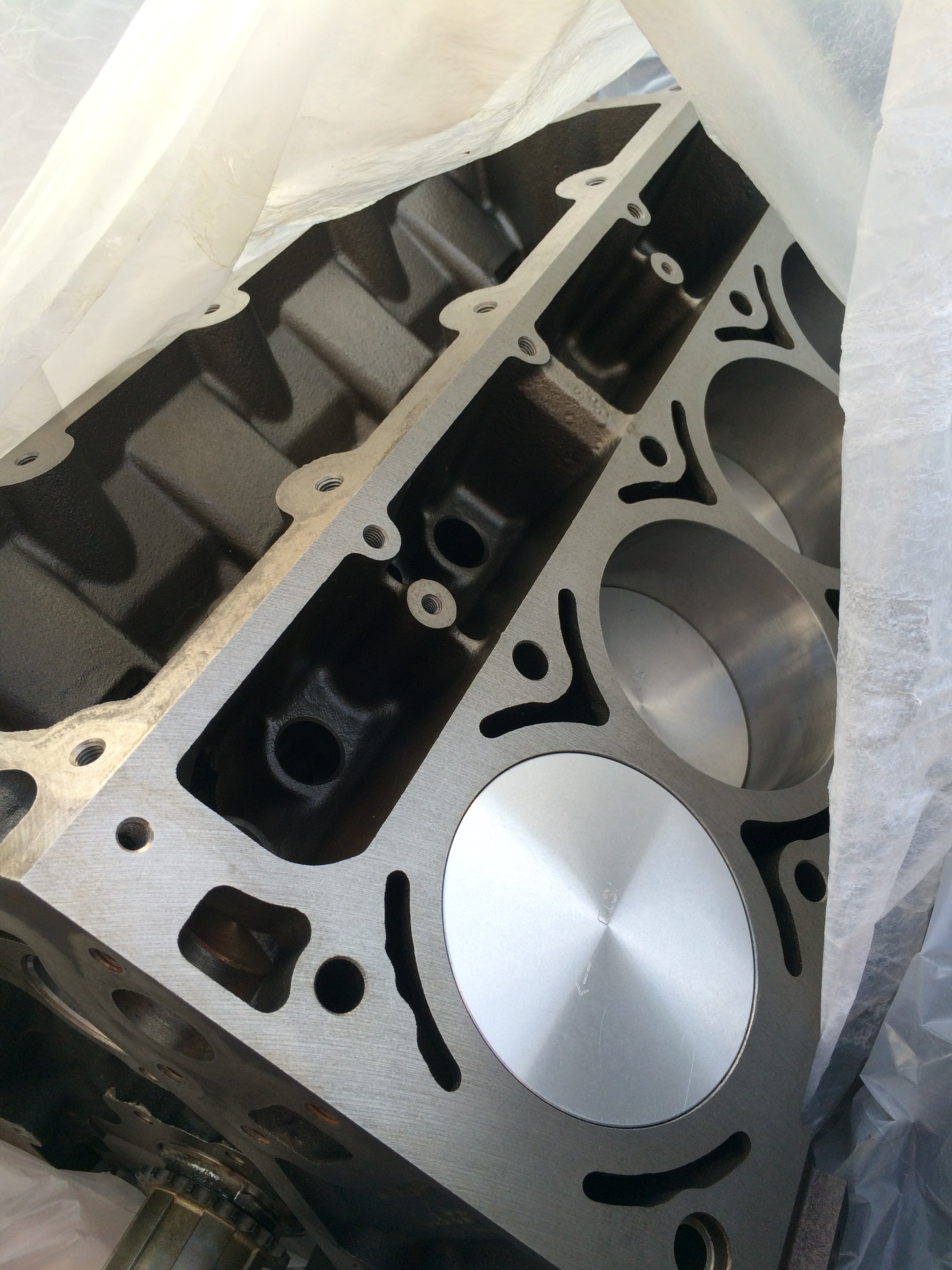

just got my 5.7 short block back today, really need to decided on a cam..
