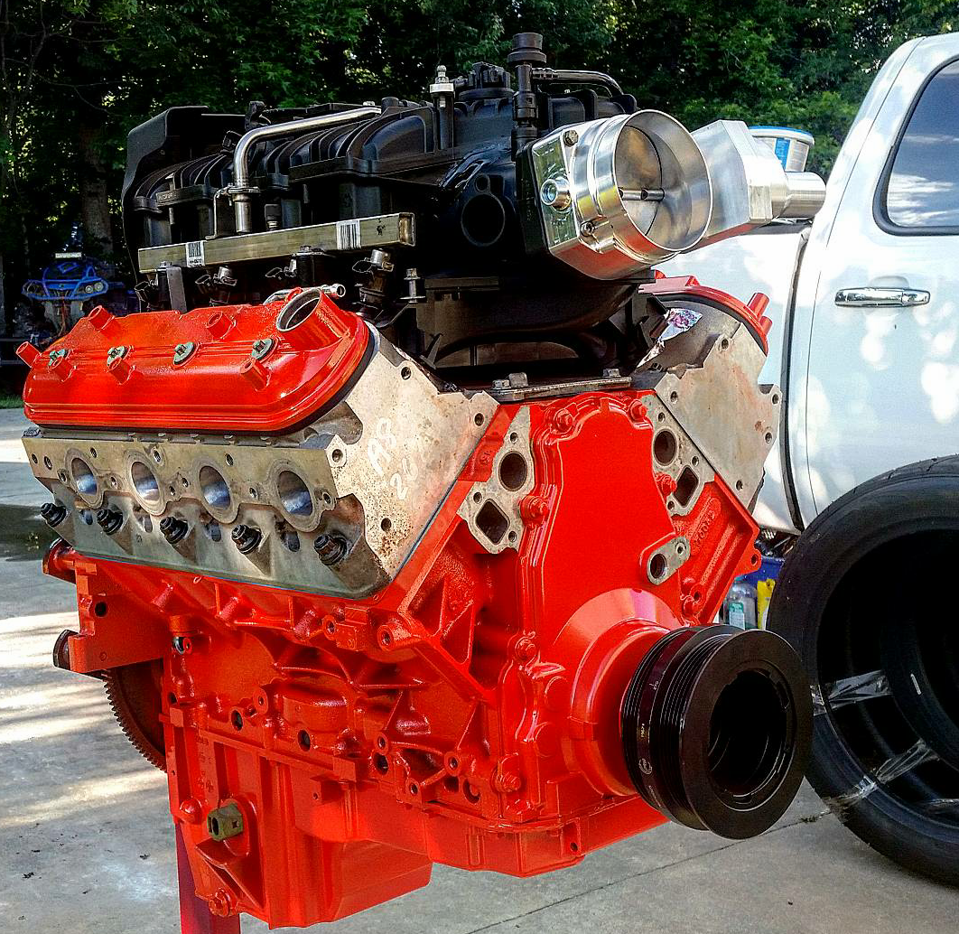

Finally got the motor done and will be putting it in next week. This thing should be a monster!
415 stroker from L92 base
All forged internals
ported intake manifold
102 tb
100mm MAS
5 inch intake piping
229/244 .624 .595 113LSA BTR cam
BTR sprongs and pushrods
LS7 lifters
Hand ported heads
Billet double roller timing chain
Melling high flow oil pump
All ARP bolts
Old May 28, 2017 | 04:07 PM
darkirish63's Avatar
Joined: Jun 2011
Posts: 640
Likes: 46
From: NC
102 tb
100mm MAS
LS7 lifters
Hand ported heads
All ARP bolts
​​​​​​​nice looking motor. We went with nearly the same color scheme...
