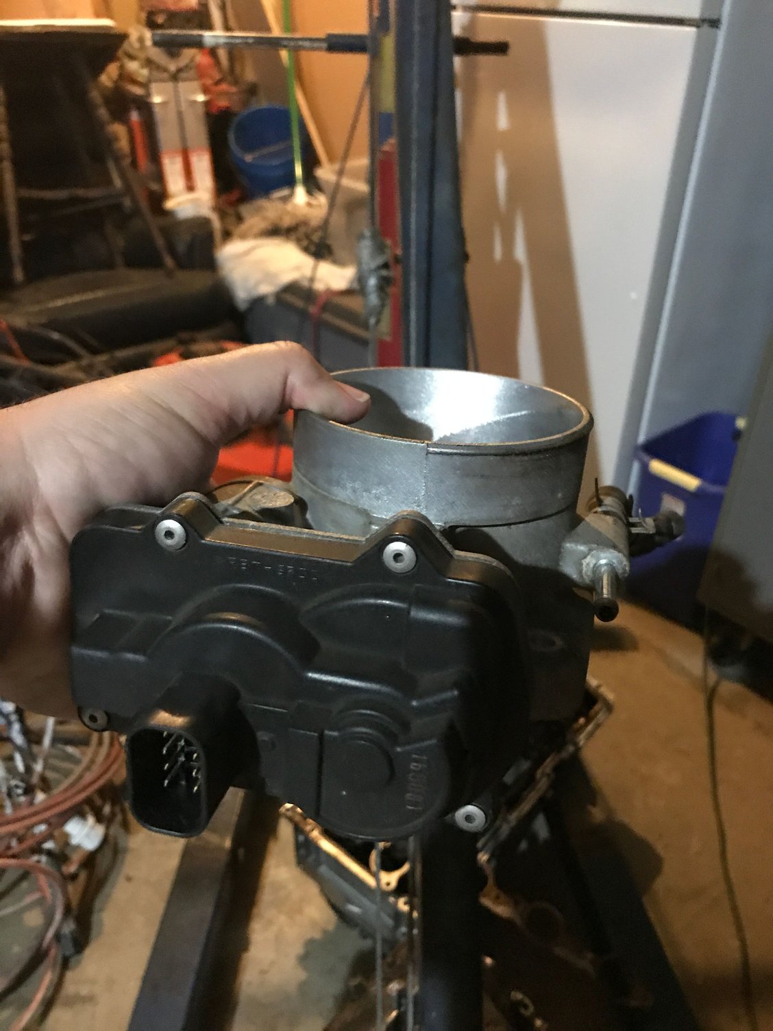

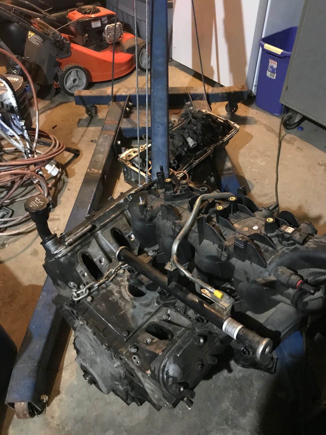

I am headed down to my garage now to get a pic of what I have - then we can go from there to see if you can help me

That's a GEN 3 motor, so it's the older 24x crank trigger.
58x motor where in the NNBS body style that came along in 2007 as well. They also have the crank sensor on the front cover, which this engine does not have.
The other question now is, do you want to keep the Drive By wire throttle body or go with a basic cable throttle body?
My personal opinion is to go with a cable throttle body, it will be much easier for you. The DBW stuff would require the tac module, throttle pedal and throttle body to be all matching from the same donor vehicle. Seeing how you only have the throttle body it would cost you alot more money to buy those other items.
When you go junkyard searching or wherever you should look for a 2001-2002 harness and computer from a drive by cable truck. Those are the best years for harness's and computer operating systems. You'll also want to find a cable throttle body too.
