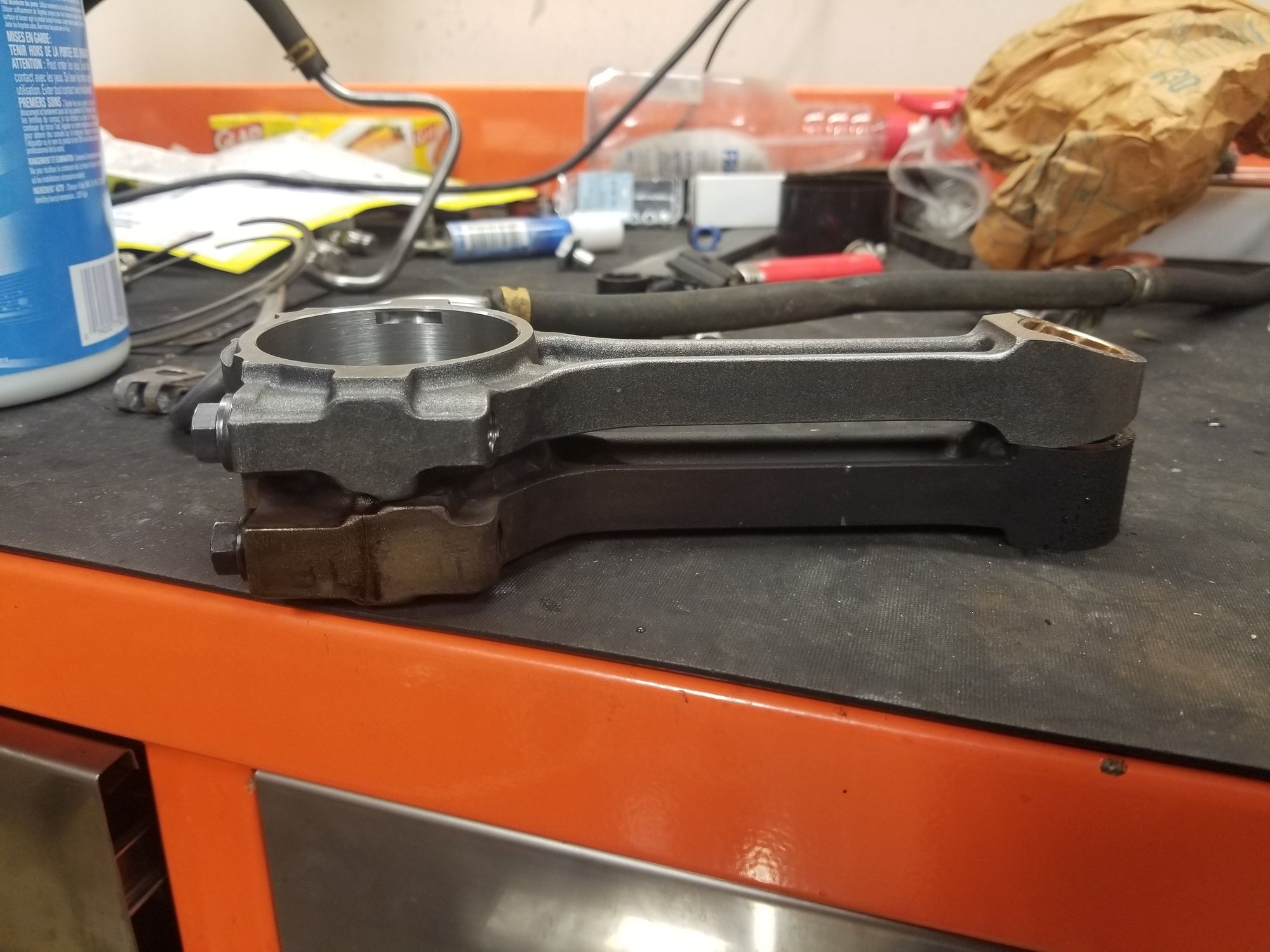

It is... or at least should be as all the other LT cranks are. The problem I see is pistons and someone making appropriate ones. The stock LT pistons are useless in an LS and GM kept the same connecting rod length in the 6.6 as all other 3.622" stroke combos at 6.098". So you will need either a custom rod and piston combo or custom pistons. I doubt anyone will bother making anything mainstream anytime soon. Here is the new L8T rod laid over a full floating pin LQ4 rod...
Same rod as any other LT...
