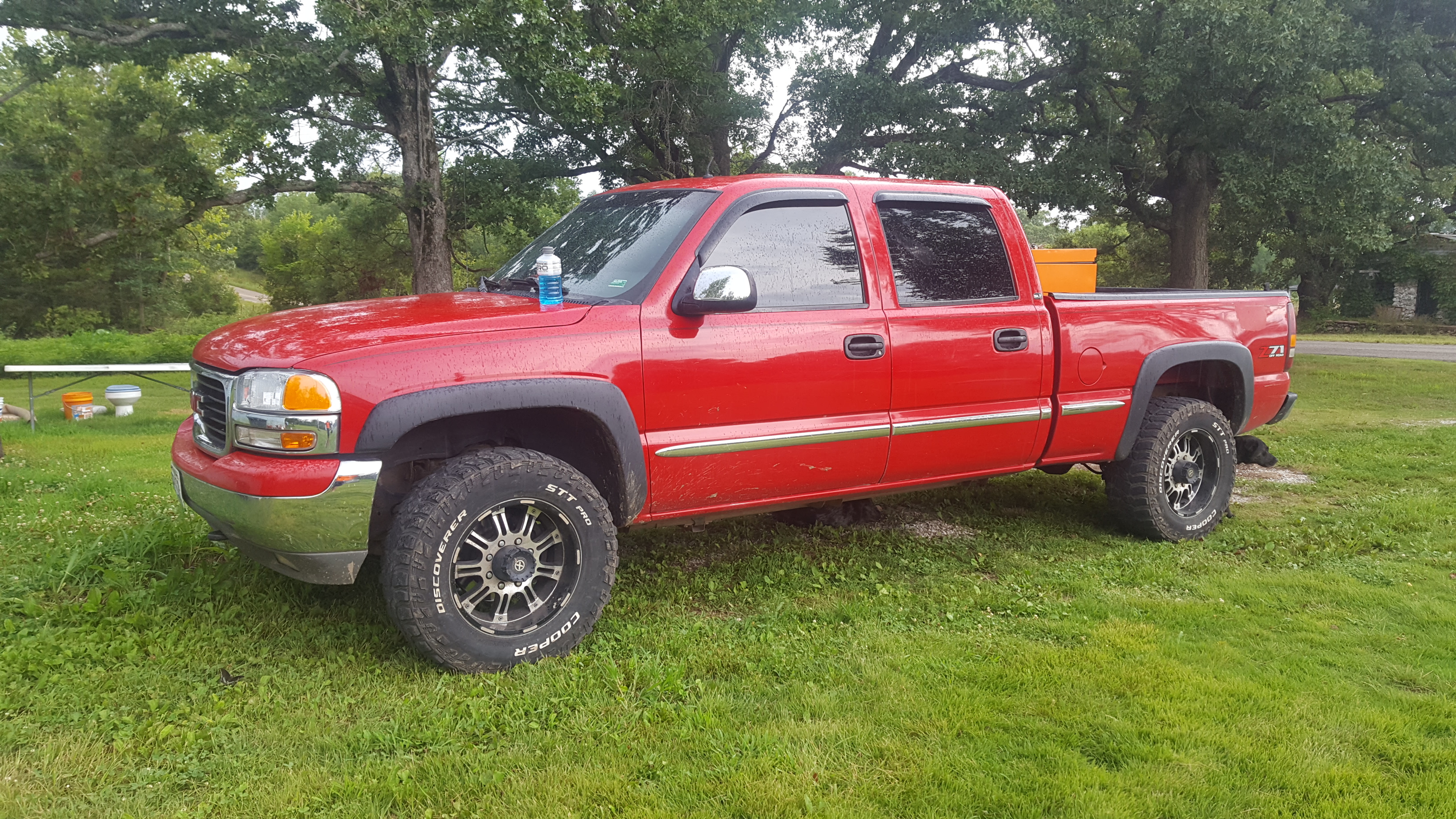

First off let me start with I'm looking at all options. I have a 2002 gmc.sierra 1500 HD crew cab 4wd with the 6.0l I believe lq4 engine. Truck has 225k miles on it and is still a work horse for sure. I notice the engine is running a little noiser as time goes on. I WORK this truck hard everyday.
With that said I want to rebuild something and have it ready to drop in when my current engine goes.
I prefer to be able to use factory Harness and computer (will end up with custom tune later). Keep factory trans for now and start using it everyday.
No the fun part. What block do you recommend? Do I put ls parts into a lq4 or switch to something different?
I don't want to go turbo I want to keep it NA. I also would like to make around 425 to 450 hp.
Any help is greatly appreciated. My truck is really clean for its age and I really want to keep working it.
