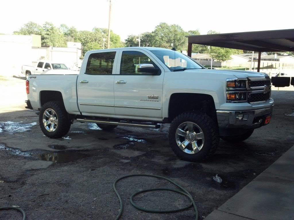

I just finished this truck today. 6" Fabtech with stock wheels and 35's. I did have to put wheel spacers on it so the front wheel would not hit the upper balljoint. Other than that, no problems.

Bit- have you put a leveling kit on yet? if so how did it drive? pic?
Also what would be the max size tire I could run with a leveling kit- I have the 20in wheels.

Yeah I have done a few on the 14's. I don't have a pic. I will try and get some. I know a 31 will clear but we haven't tried a 33 with a leveling kit. I did a 4" lift and 33 cleared just fine.

Ok thanks. A pic would be sweet to see with stock rims/bigger tires
