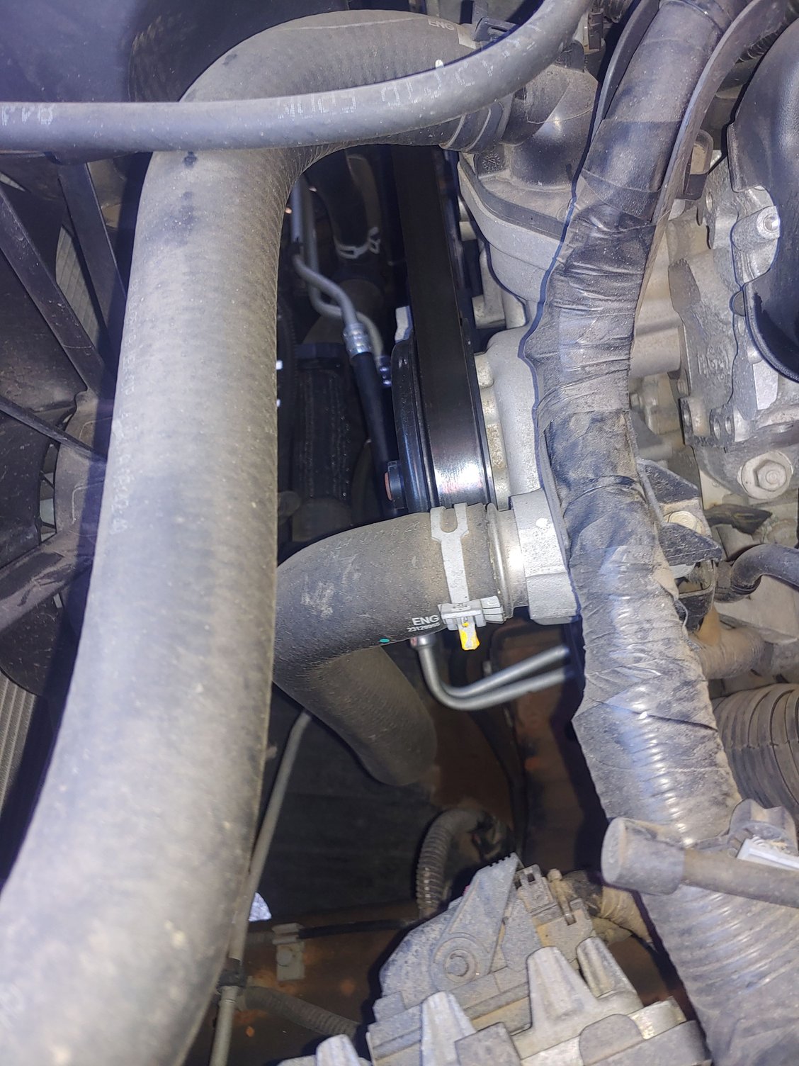

Made it home while keeping an eagle eye on the oil level, which caught at half a quart low per 700 miles. Seems that if I wind it out a little here and there oil consumption is reduced.................

Update, took the truck in for an oil change and a once over- while down there they found the oil cooler lines were leaking and the service writer droned on about how this is like almost a wear part that regularly goes. Anyhow- under warranty the lines were replaces and I'm all good.........
