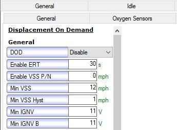

Not familiar with the device you mention, but I have DOD disabled in the tune
