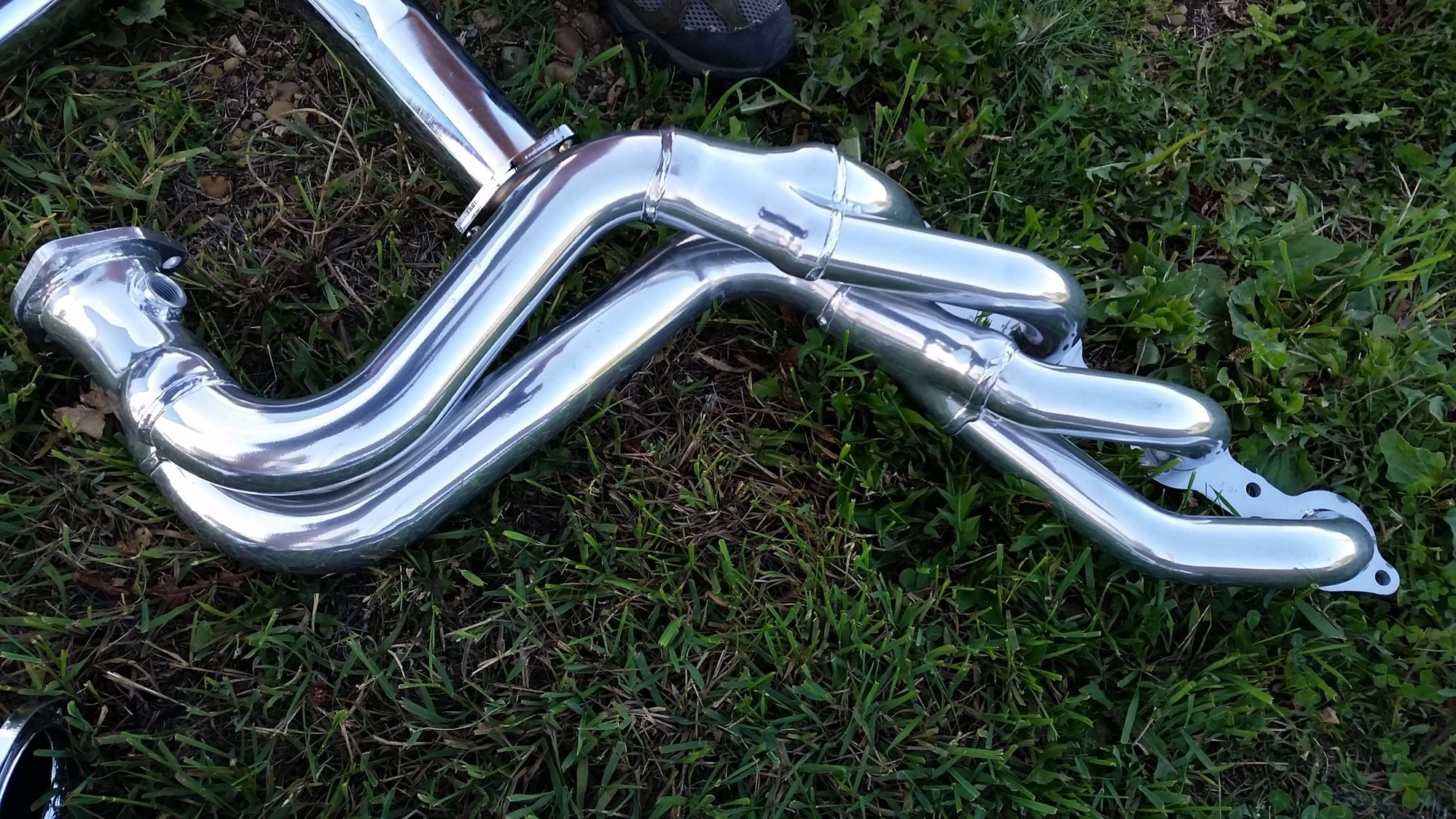

Doug Thorley catless Tri y headers.

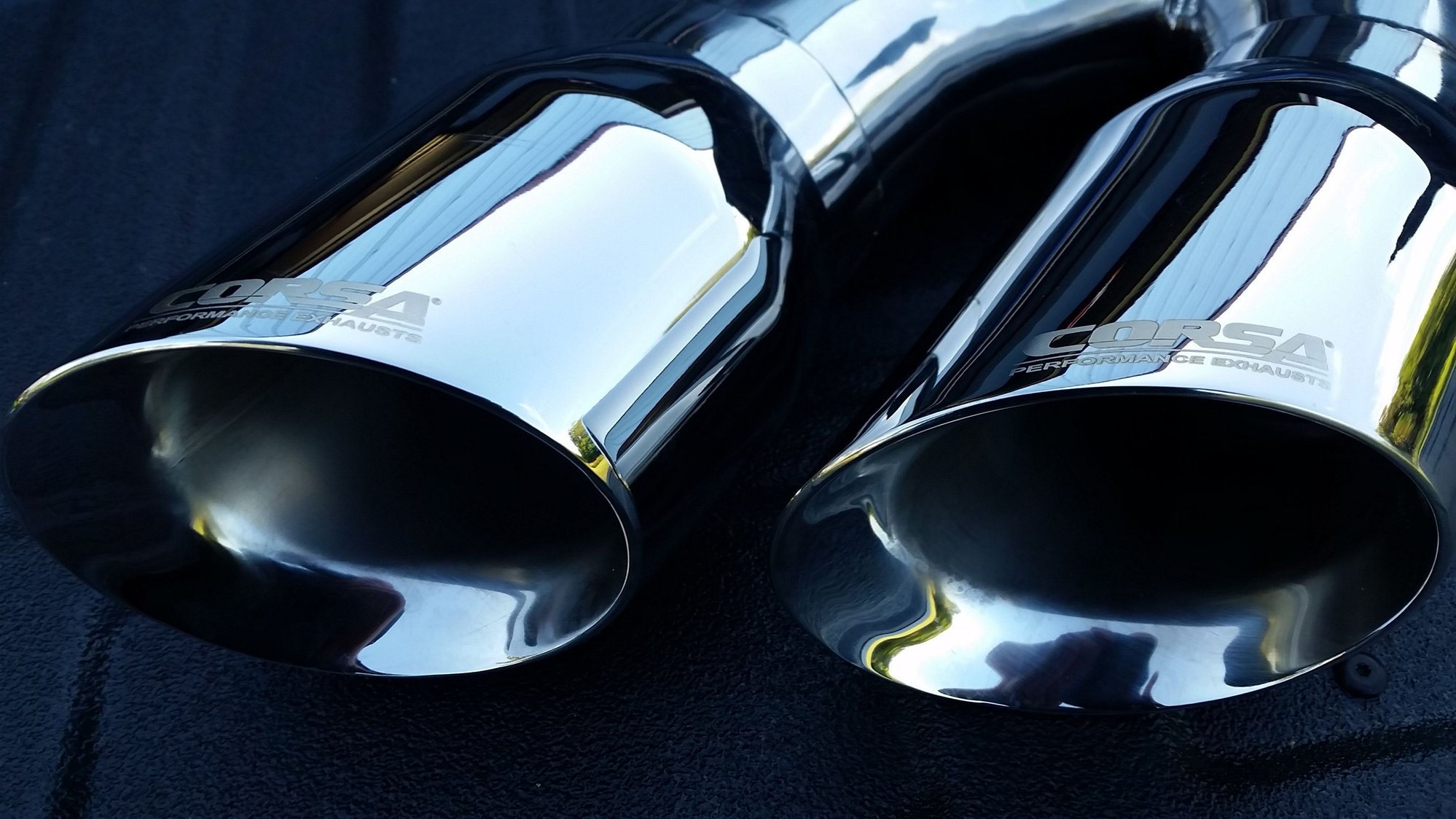

Corsa sport catless exhaust system.

Did you have to fab your own y-pipe for the Doug Thorleys?
The thorleys came with a y pipe. But the connection doesnt mate up with a stock catback connection. Had to drive the truck with open y pipe and the corsa catback not connected to an exhaust shop for them to make up the final tie in.
Catless headers and corsa sport is LOUD AS F. Its not your typical deep throaty american muscle sound but more like a corvette C5R racing car sound lol.
