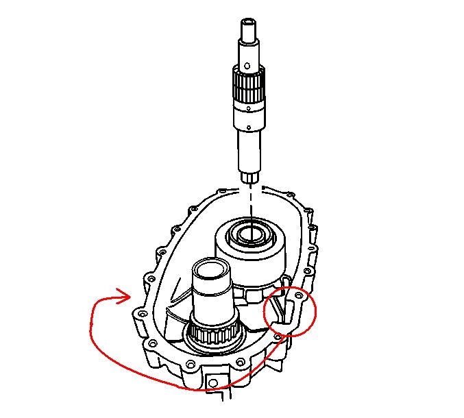

Yes 21 is the actual tube and it has a little black plastic filter end. Clocking it to a different location is not possible due to the slot cast into the tcase housing there is nowhere for it to go if you tried clocking it a different way.
Also, I am still considering modifing the 149 t-case to work at the right side of the car:
We need a 2WD to 4WD/AWD thread-t-case-oil-housing.jpg
