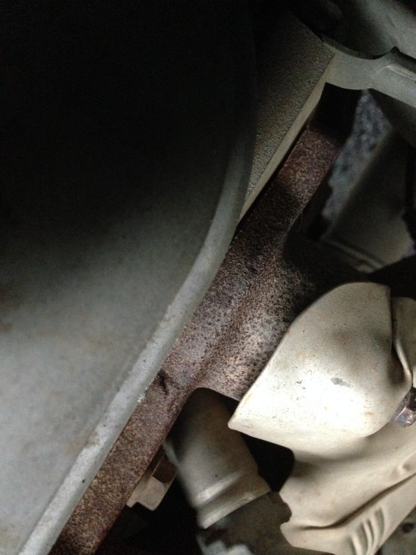

About 4 days after I bought the truck I heard a loud tick under the truck. Fearing it was the AFM lifters I started investigating with a home made stethoscope. Valve train sounded fine and couple of my pulleys need replaced but weren't making the sound. I recorded a video of the sound(click here).
Turned out the rear most exhaust manifold bolt was broken.
