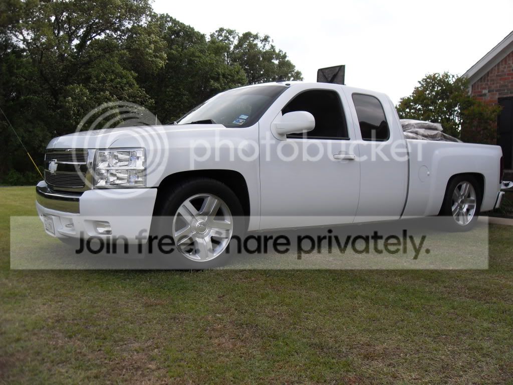

And yea I've talked to you before on gmfs before I believe. Here is a picture of my truck. (refresh your memory.)
