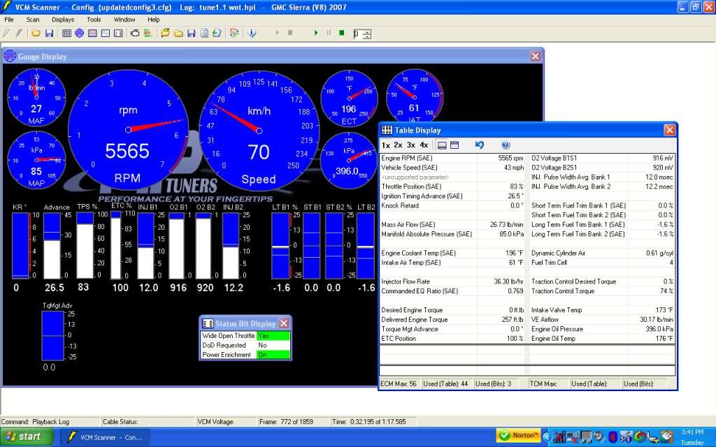

Hope this helps, look at LH side of chart TPS says 83%, look down same side and ETC says 100% plus am in WOT with status bit.
