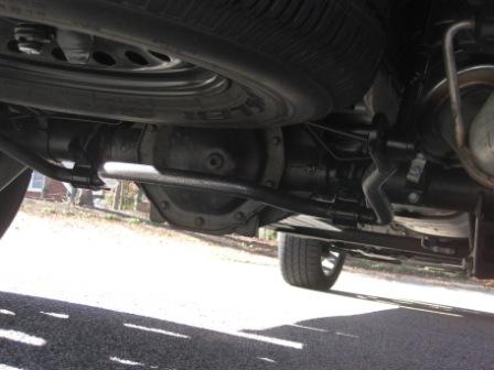

2008 SD AW with Hellwig 7800 rear bar.

You may not need the additonal kit. The kit is only 2 1in blocks, spacers, that move the sway bar out of the way of your trans cooling lines. When I installed the front bar I did not have to use the kit. There was approx 1/2 to 3/4 in clearance.
