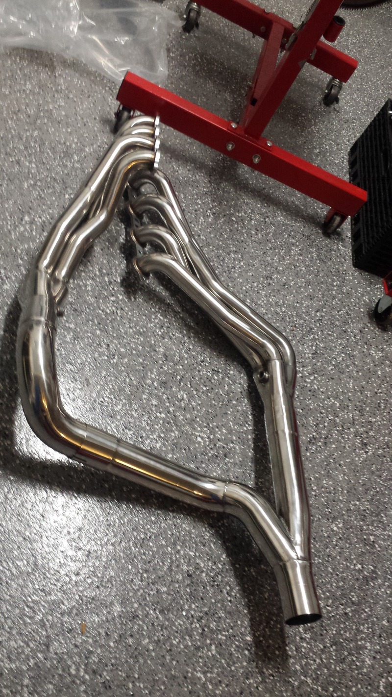

I got my y pipe in today. It slides right over the Texas speed headers no problem

Yes I have the texas speed y pipe with the speed engineering headers and the 6l80.

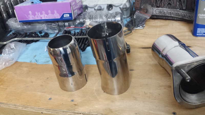

Size:  131.4 KBnot Sure what the 2 pieces are in the bottom picture

Different adaptors for different connection pipes...

Well that looks pretty good, when you plan on installing?
