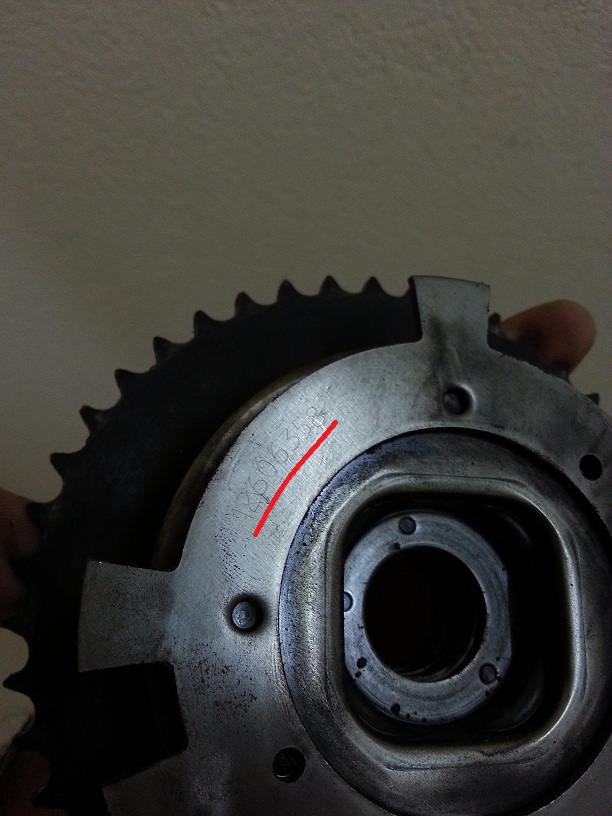

mine turned out to be a 358

I'll try to pop that cherry now , using comp cams instructions
Old Nov 23, 2012 | 04:47 PM
  #56
sand man's Avatar
Joined: Feb 2009
Posts: 1,020
From: Saudi Arabia
did a mock up on my left over 358 ,
15 min. max for a none experinced mechanic if you do have the right tools
all you need is
3/8 ratchet
T25 (provided by compcams)
1/4 socket to adapt the provided trox bit
vise grip
cloth,old shirt, I used some cardbord
thats it

**** , I need the 994 for the 156 core
