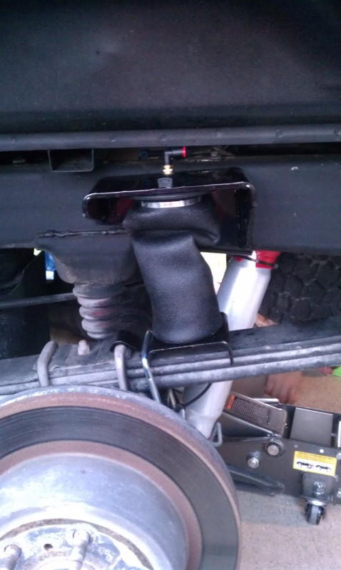

When trying to install as per the instructions the bags are too short. If the upper frame bracket is held in place where it should be the bags need about 2.5 inches longer to give proper suspension travel wo damaging the bag.
Yes I inverted the upper brackets. With the tool installed to center the bracket and space it properly for the correct height I have exactly half of the upper bracket hanging down below the lower most edge of the frame.

Before I primed the bags and attached the air line
At ride condition

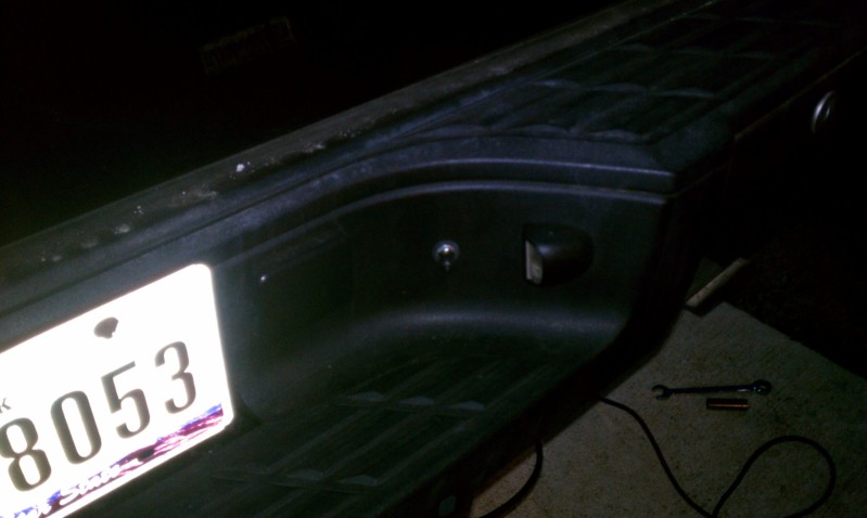

I mounted the air lines 2" off the license plate light since there isnt any metal behind the plastic there and its damn near a straight shot over the frame and to the top of the air bag. Didnt even need to use any zip ties to keep the line where it needs to be.
At ride condition

The tech support guy I talked to at airlift this evening said that even though the truck is a 3/5 drop in a flipped axxle configuration I need the airbag kit for a 4wd.
I guess I will order that kit and then sell the kit for the trucks slammed 4 to 6 inches and see if the new kit fits dunno. But completely screwed me towing our rock crawler to colorado saturday. Ive had this kit for a month but never put it in bc everything looked perfect. dammit teach me to think
