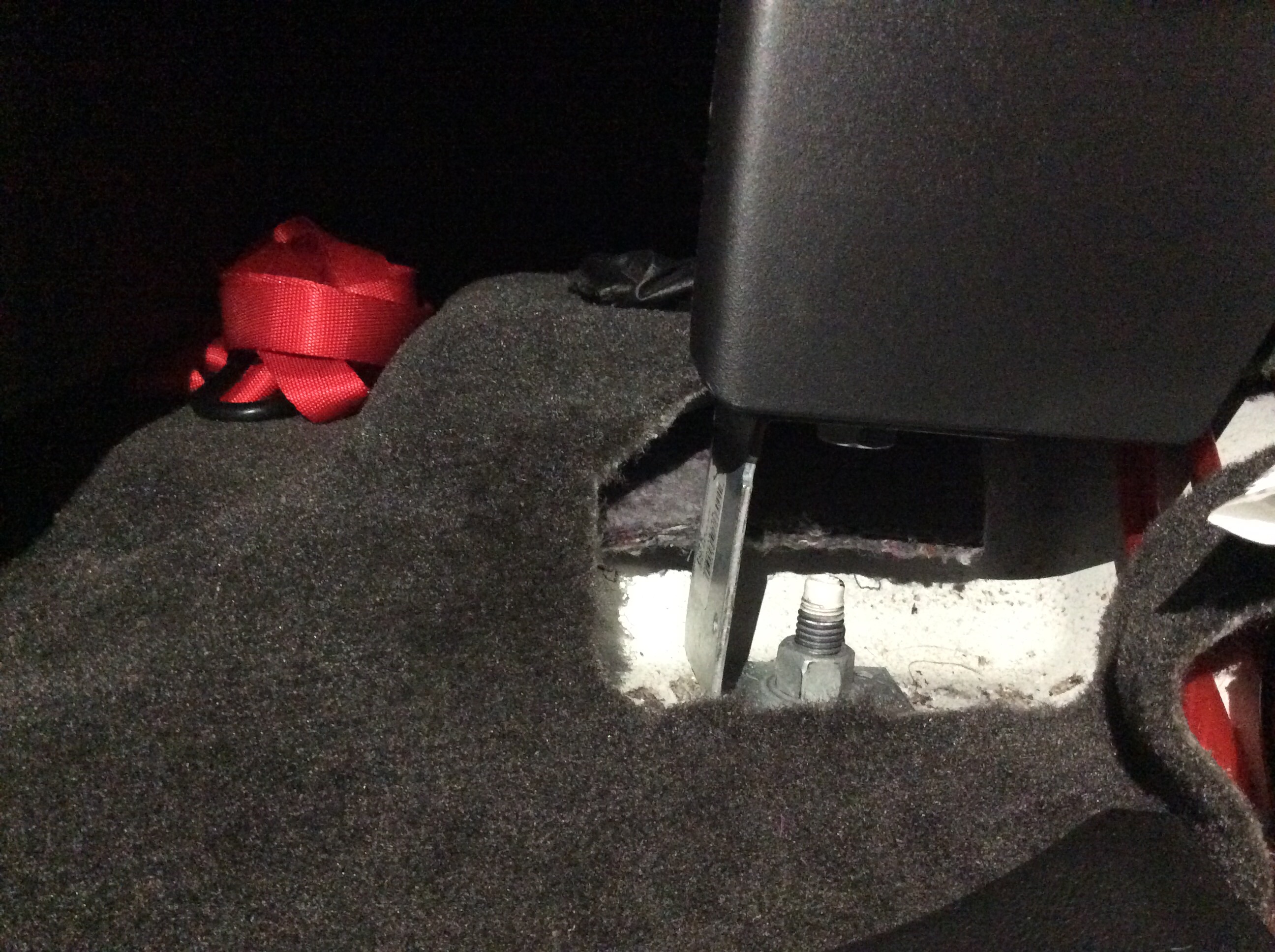

New method. They come with one end bent, and the other straight like an "L". Had to bend it into a flat "U" shape. No drilling as it has both holes, and once the other end is bent over the holes line up. Almost to hold a 2x4, in the electrical box to 2x4 section of Home Depot. Every time I do this it is all new.PM me with any questions.
Same hardware, 1/2 inch with lock washer and nut, but on all eight bolt downs.
More pics soon.
Attached Thumbnails Rockford Fosgate T1 12's Under the Rear Seat in NNBS-image.jpg
