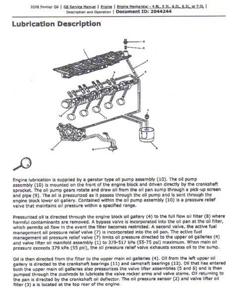

Old Nov 21, 2013 | 03:27 PM
Preston129's Avatar
Joined: Feb 2010
Posts: 1,192
That valve vents pressure for the AFM lifters.
Old Nov 21, 2013 | 06:00 PM
splinter's Avatar
Joined: Jan 2012
Posts: 153
From: Newport Beach, CA
Yup blows off at ~55 psi.
Note it’s also included in some non-AFM combinations, likely owing to hardware deproliferation edicts.
But who here hasn’t deactivated cylinder deactivation? :D
