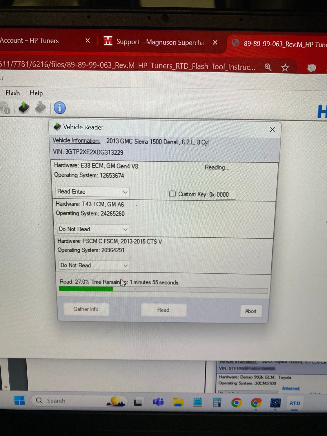

Going back to FSCM tuning. Not sure if this only pops up for 2013 models but tonight I connected my laptop to the truck with HP Tuners RTD to read the stock file so I can send it to Magnuson for a tune file which in turn I can have my tuner remotely start building the tune for the ID injectors, cam, etc. one thing that caught my eye is that my FSCM calibration comes up labeled as '13-15' CTS-V right from GM.

That's normal, the few 2013 trucks I have tuned have had that. I never touch it or license it though
