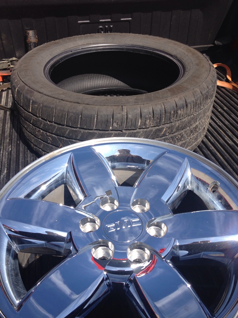

Have the tire dismounted
Attachment 119498
This helps alot!

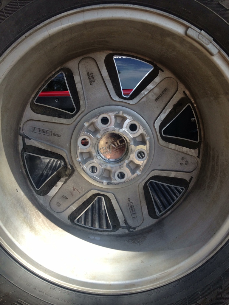

Look behind the rim, you'll see this
Attachment 119499
This is what we are trying to get off! I find the easiest way is not to beat it off with a hammer, but use a 3 foot long 1x1 piece of wood, and put alot of pressure on the back side of the cladding. Small guys might need a friend to help, this shit is on there!

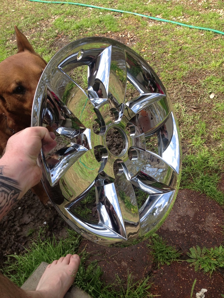

The cap will let go
Attachment 119500

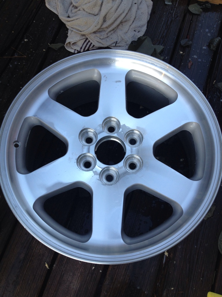

I find a plastic scraper and rubber hammer work best, get under it and work it off
Attachment 119502

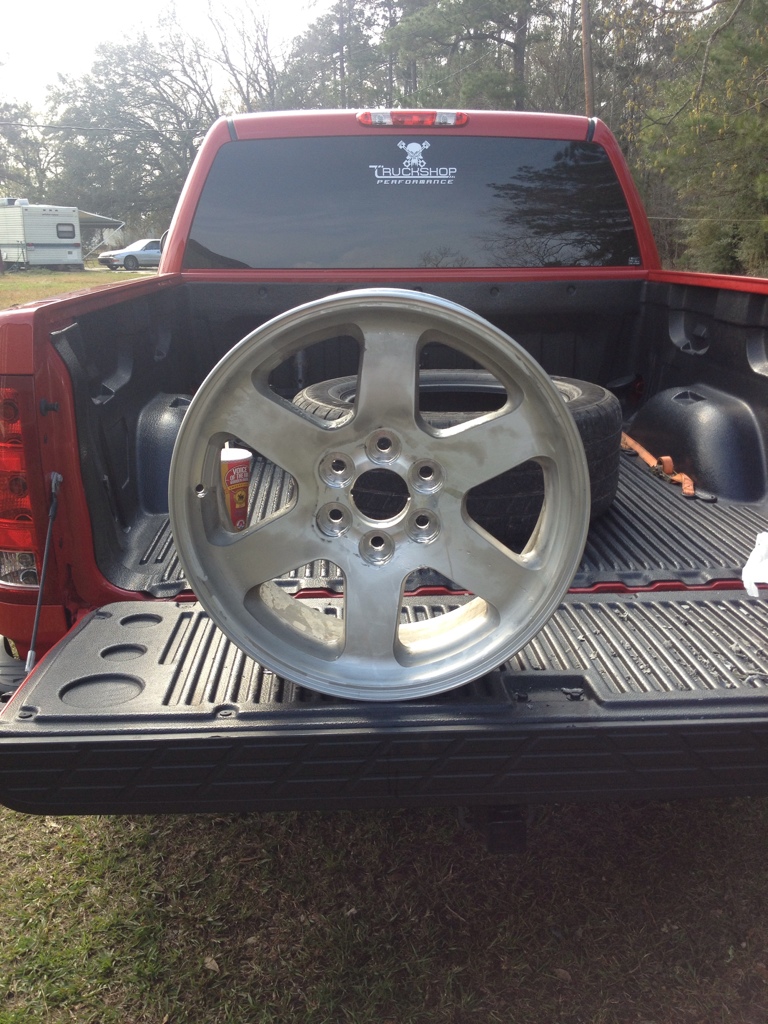

Once you get all the foam off, your left with this
Attachment 119503
From here, paint stripper does wonders!
Attachment 119504

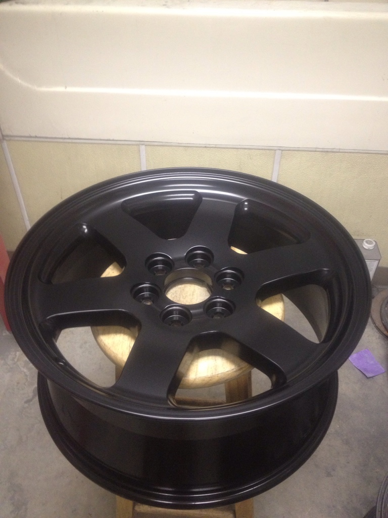

Now it's your choice

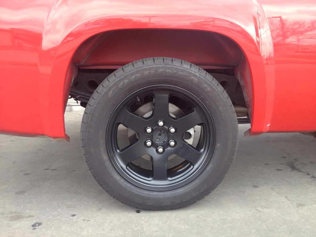

You can sand them down and polish them, paint em, powder coat, whatever floats your boat! I had mine powder coated low gloss black
Attachment 119496
Attachment 119497
And your left with a sweet set of wheels for not that much change!
