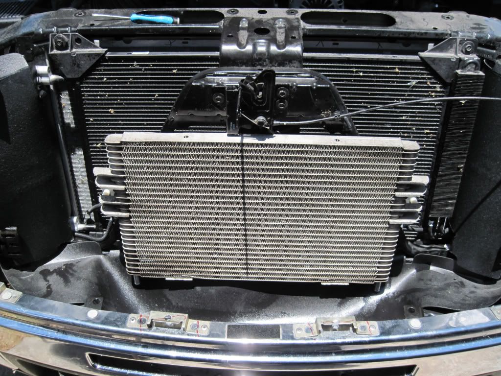

Here are some pics... I also installed a filter mag.
Also installed some lube guard.
Nice Pan!!! Any difference?

If your really concerned with trans temps get this cooler. Same width as a tru cool 40k but with twice the height! It's a factory option f 250 trans cooler
Happen to have a PN on that???

Think the Ford PN for that cooler is (PN 5C32-7A095-CB)
