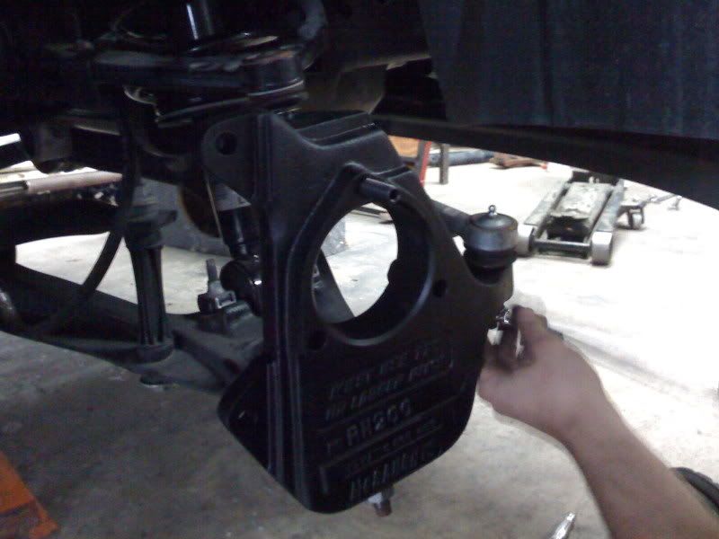

Heres a fresh install of MCG spindles (he spray painted them black) and as you can see the balljoints dont seat fully into the spindle. I verified with him if they were tight and he said yes as tight as they would go, and he mentioned MCG even said in the instructions that the balljoint wouldnt seat properly and that was normal. It may be normal for MCG, but stock they seat fully and on the GF they seated fully too.

yeppers thats how mine was. i had to wiggle the boot down to cover the rest of the balljoint properly.
In my book, balljoints not seating fully=upper control arm in higher position than stock=not stock geometry.
