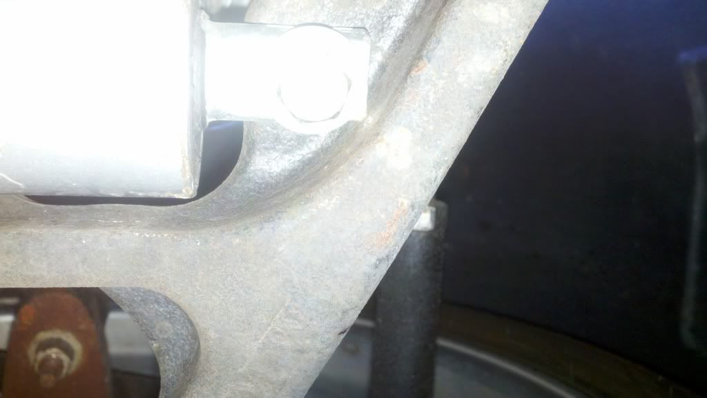

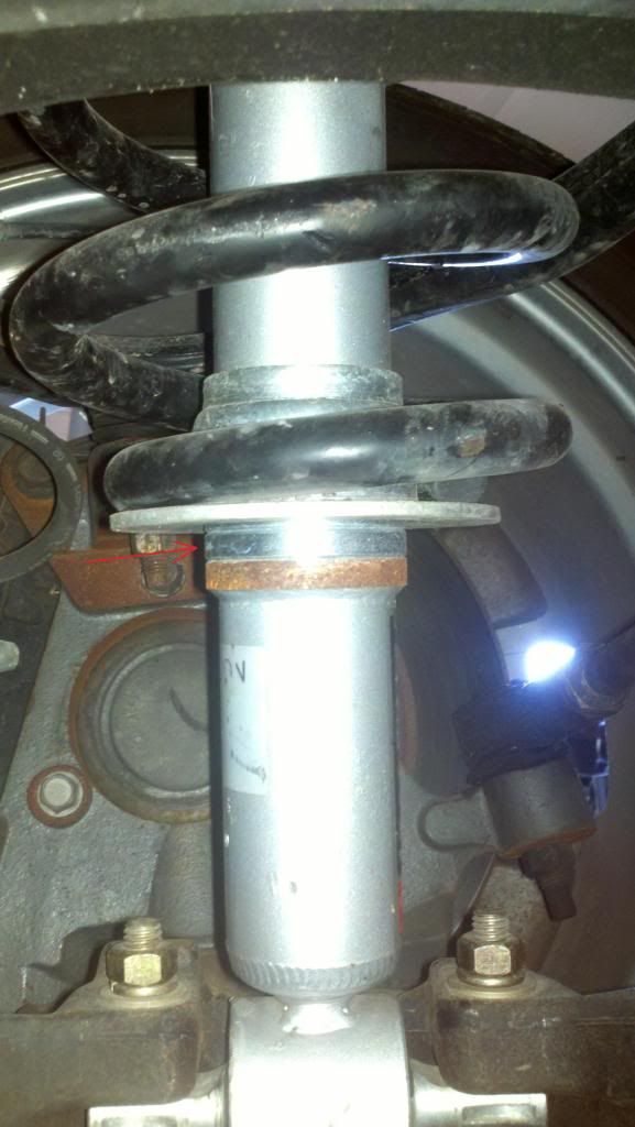

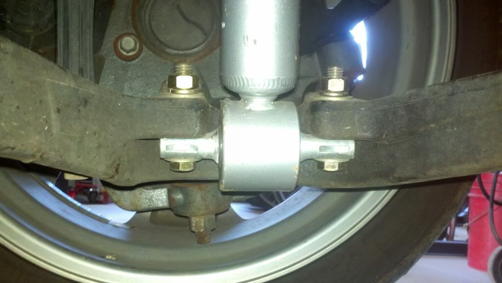

Originally Posted by bigwillys58
Pics as requested. The bolts i used are 7/16-14 grade 8 Just a fuzz bigger than the factory 10mm bolts. if you do this DO NOT use the factory tin nuts. buy real hex nuts if you want to reuse the bolts. used flat washers on both ends with a lock washer behind the nut
if you do run on them on the bottom of the a arm you need atleast one full spacer showing under the spring bucket other wise you will have bad camber problems even with a camber kit. ask me how i know haha. (as seen in pic with 2"spindles netted a 5"ish drop)
also you will have to grind a smidge off the ear facing the front of the truck so that it sits flat on the a arm. maybe you can see how the corner pocket of the arm is rounded. i ground just enough on the top side of the ear and on the corner edge to make it sit flat.
