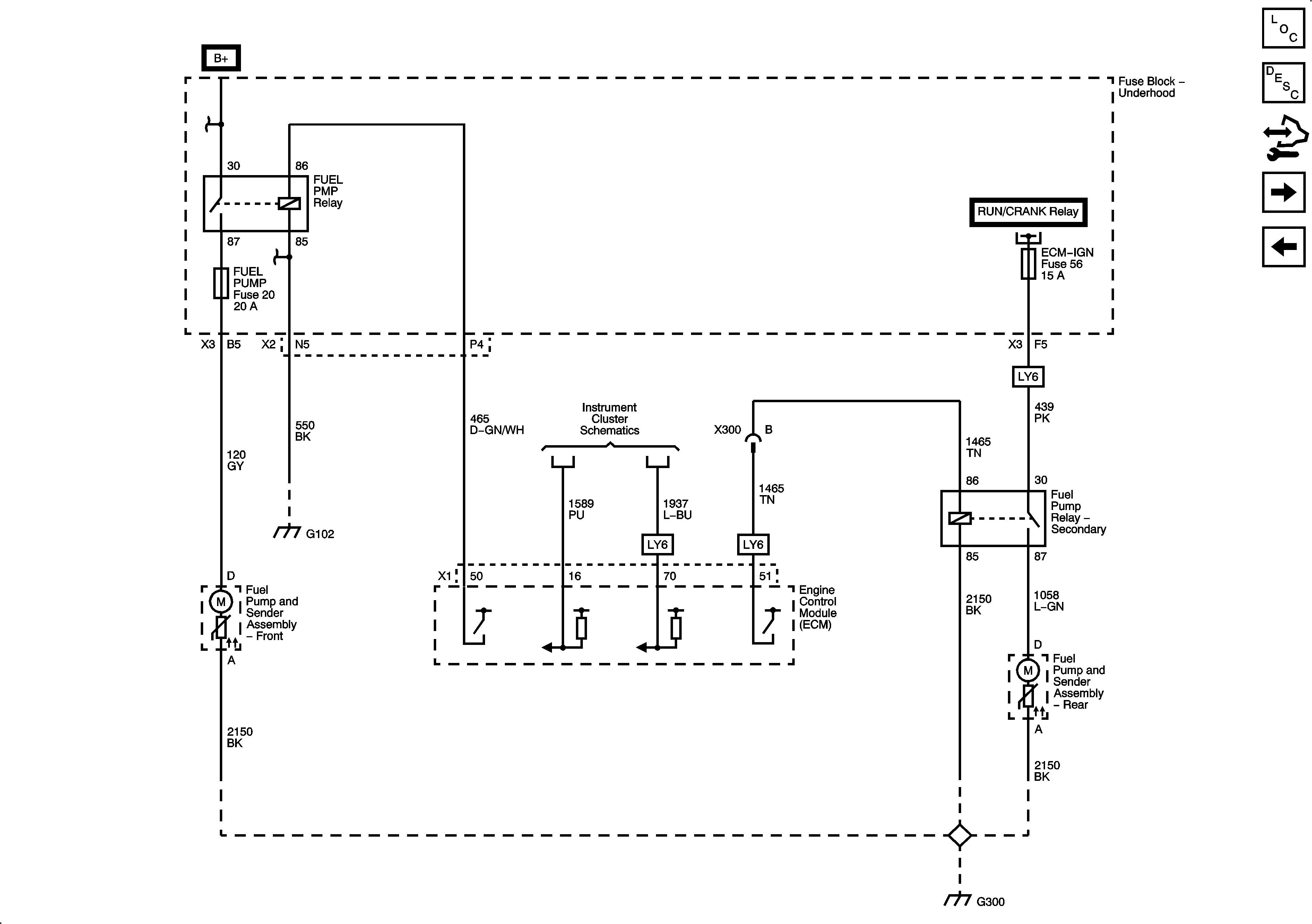

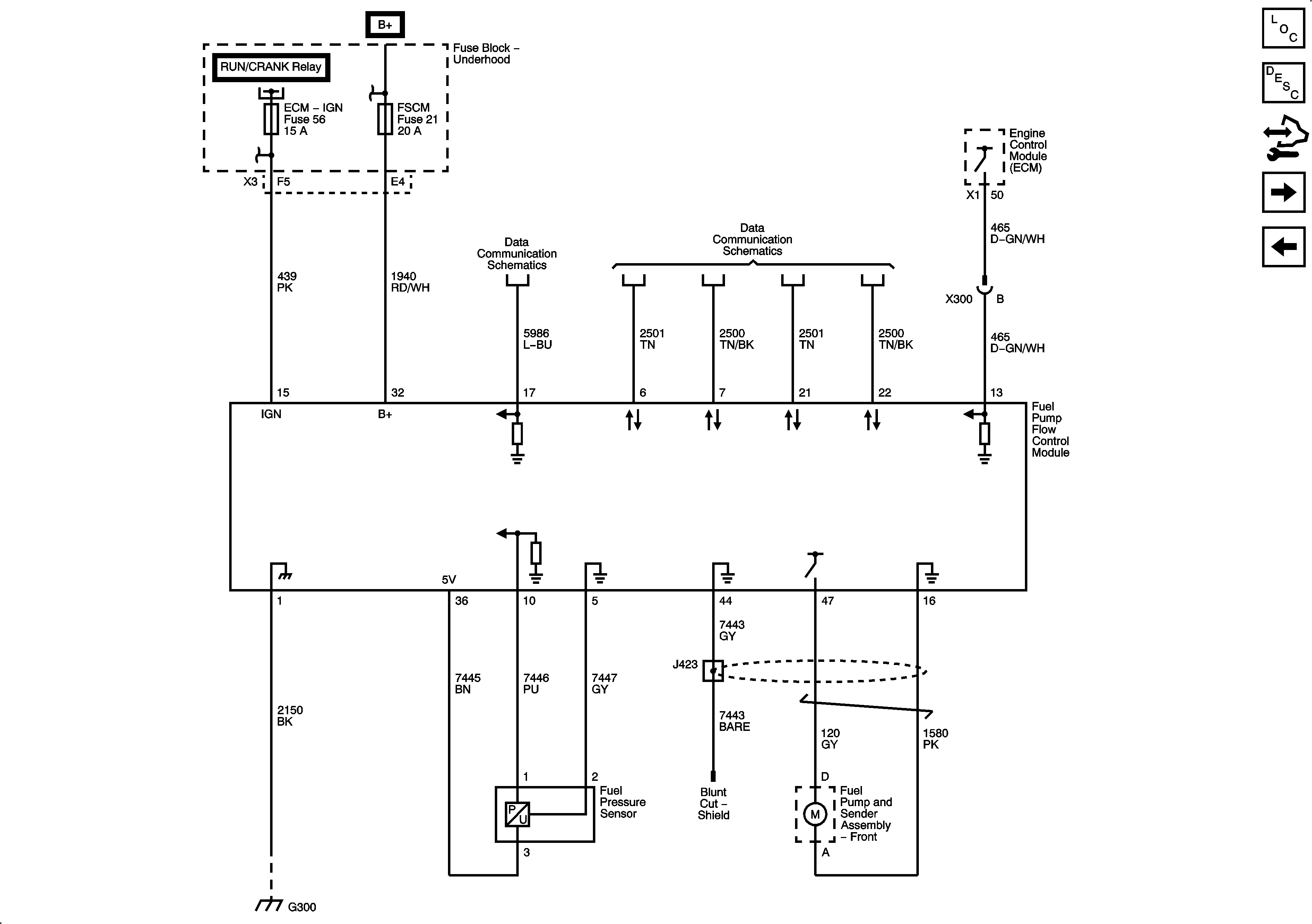

I just looked it up and appears you would be fine as 08 info shows same engine setup as 07. Easy to check too, there should be a fuel module located up near the spare tire on top (looks like from diagrams) of a frame cross member.
That is about all I know, I was looking hard at swapping 6.2L/6L80 over until I ran into the fuel module issue because you are looking at rewiring a bunch of stuff, plus extra sensor in the lines, the module, different lines, etc...gets kinda complicated...by the time you do that plus the dash readout plus the shift lever, tranny crossmember, driveshaft, programming etc probably not worth it vs modding 5.3 (or putting in a 6.2) and leaving the tranny in place. I have the LMG/flexfuel 5.3.

Two pics attached of 08 fuel system wiring, first one is LMG/LY6/LC9 engines (no module) and second shows everything else (in case anyone else might be interested this also applies to 07's)
Hope that helps a bit.
