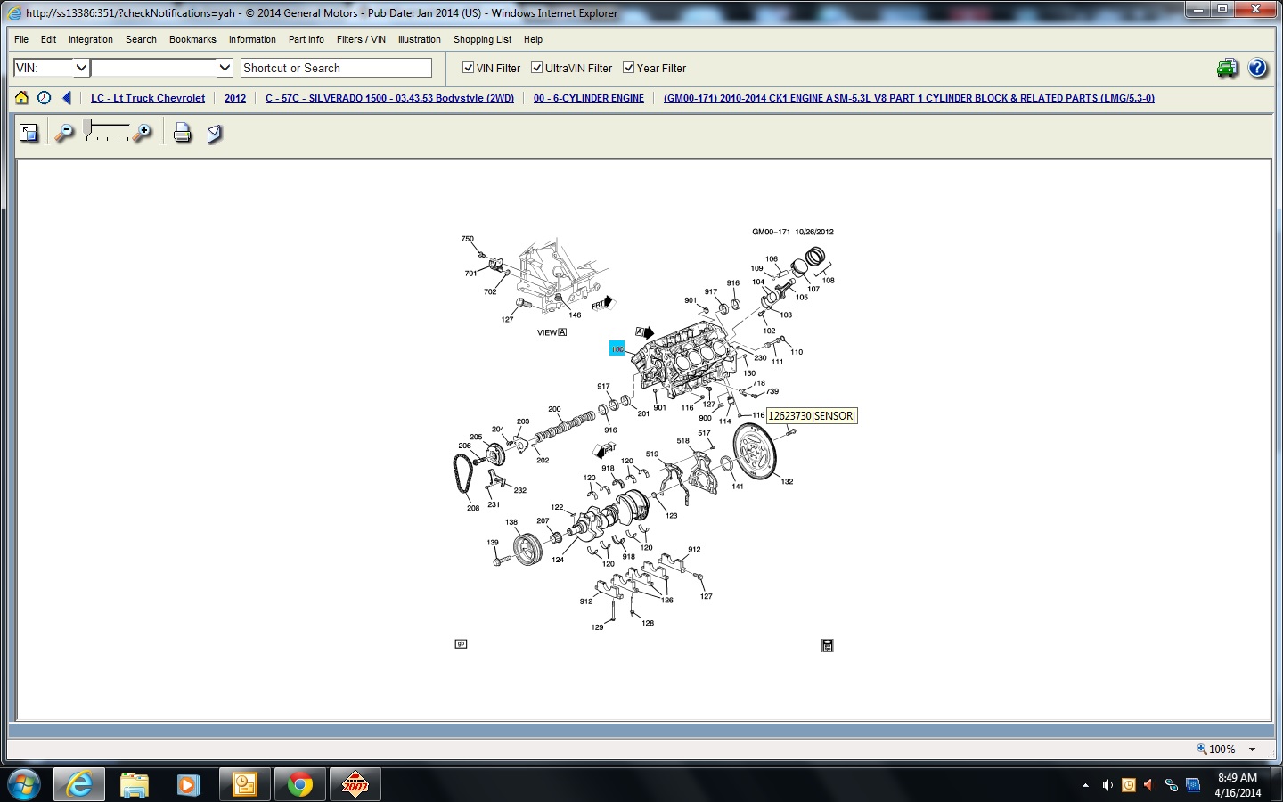

Originally Posted by chanin6929
That's what I assumed considering I could find no info on that. Thanks for verifying for me! I'll just have to take my chances with the single bolt setup. I'm sure there are plenty people that run high HP applications on it without issue.
Maybe this will help you see it...

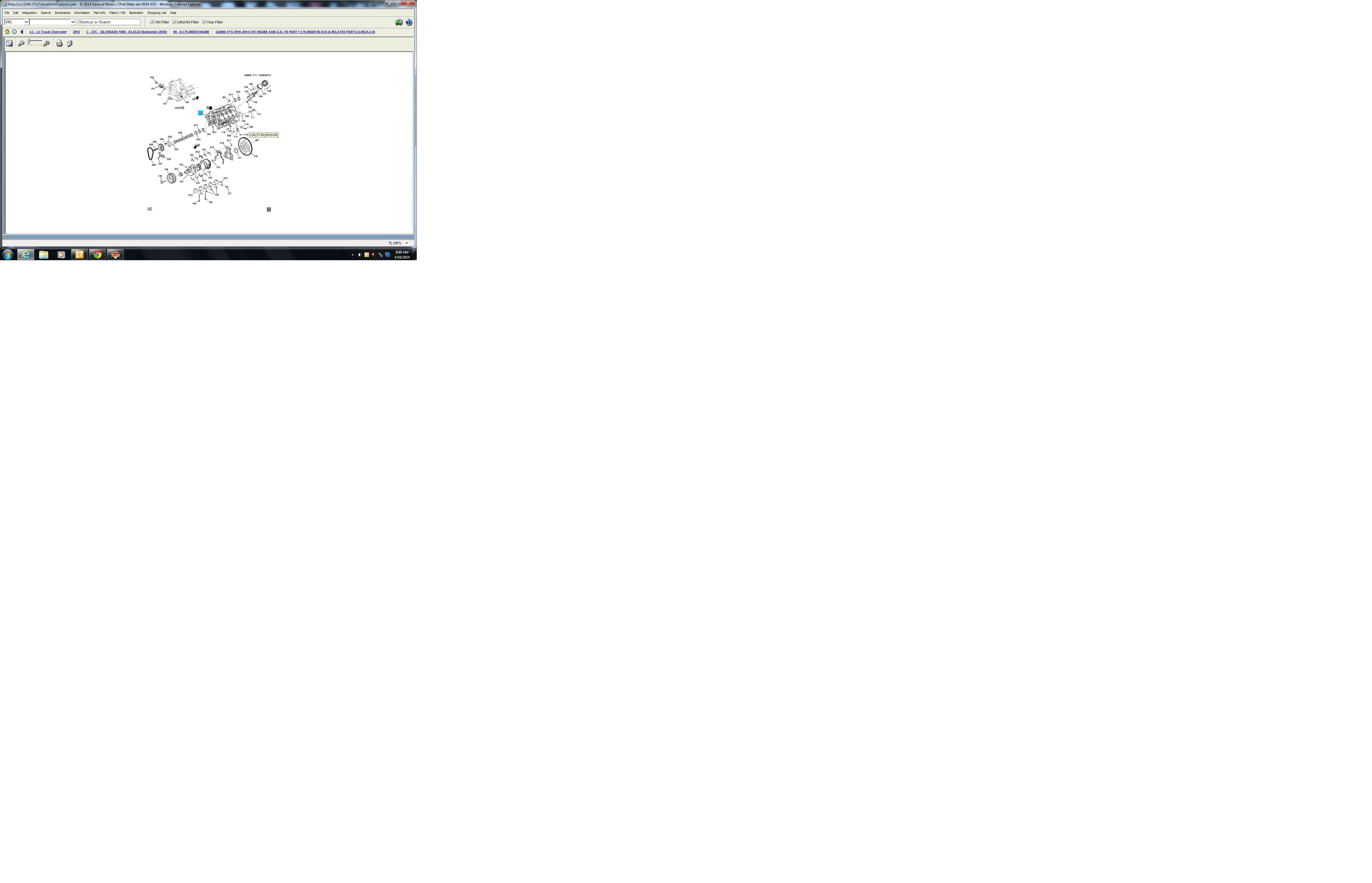

lets see if this is a little bigger pic for ya...
