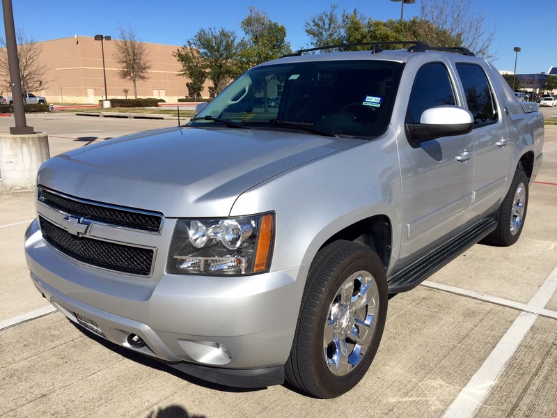

Pic of truck....has 96k miles, 5.3 runs fantastic, good oil pressure and mileage just want a little more power
