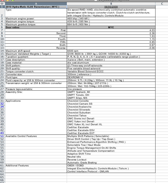

From the ordering guide it looks like the steepest gear you can order on a 2010 reg cab is the 3.42. The first gear of the 6 speed is a stump puller (4.03, 2.36, 1.53 1.15, 0.85 and finally 0.67) vs the 4speed (3.06, 1.63, 1.0, and 0.7) so I think its gonna be pretty quick with a tune for the electronic throttle etc (I'm sure stock gm will make it sluggish via software for the warranty)...it also gets rid of that extreme drop from 1 to 2nd on the 4 speed so the engine is in the powerband more.

no direct 1:1 gear for the 6spd?

Not according to GM. Pic attached from GM media online, 2010 info:
