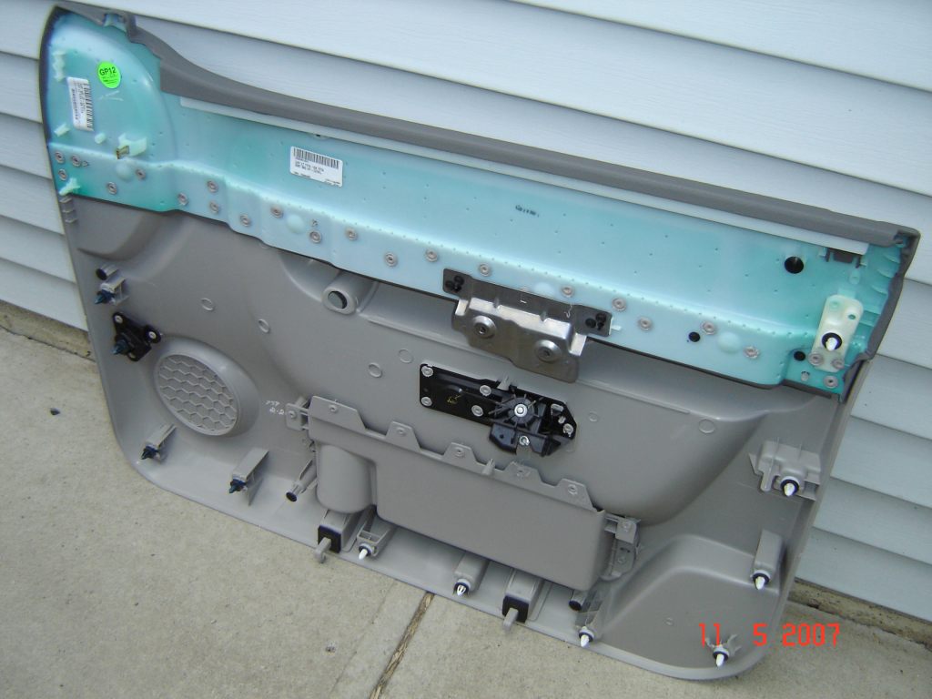

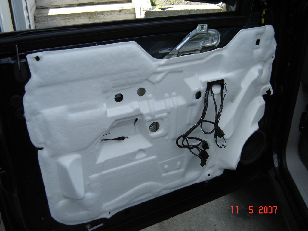

Did the drivers side today. It went much smoother, didn't mess with the interior handle, the mirror caps came off easily, as did the old mirror glass connectors (pass side were brutal!) Didn't have to remove mirror from truck....just pulled the new wires through the mirror housing with some lockwire. Left the sound/moisture barrier attached somewhere at all times, so went fast. Less than 2 hours start to finish, and not rushing, no point damaging anything.
Drivers side has door lock of course. Held on with one wire spring clip, found it easiest to pop clip off before handle came out, then took the rod off the lock assy once handle out (tough to get at when in door but can work through door handle opening). Clip back together on handle install.

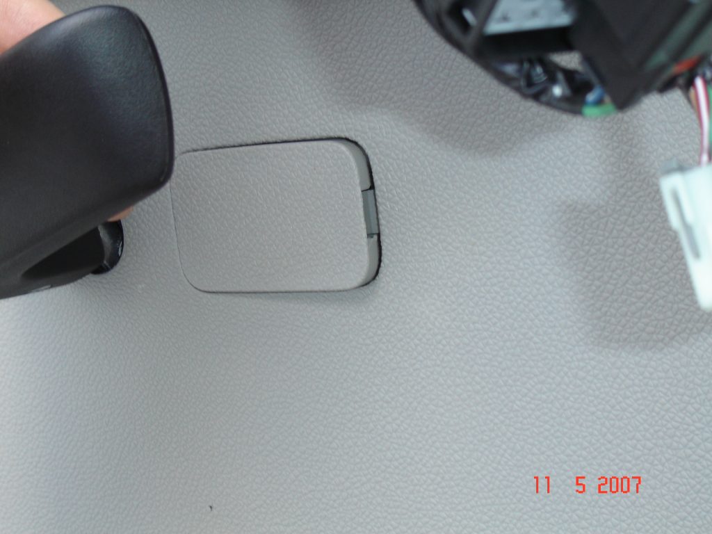

Few more pics attached to maybe help a few guys out. As usual the really interesting stuff (disconnecting latch from panel) no pics as hands were full...note the two hooks at bottom of door panel that sit in slots in door, very helpful when assembling as takes the weight while you line up. Also note interior door handle mechanism and location of attach clips. You can really see the latch ball end cable in the one shot of the barrier. Also one closeup of panel under interior handle. Note the slot at front..these things are tight so if you come in from the top it will keep snapping back into place.

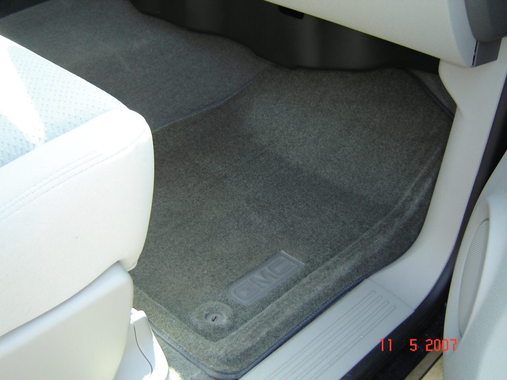

Oh yeah, and last but not least my GMC carpet floor mats...make sure you order for REG CAB, they are NOT the same as others. P/N 19155774 for Dark Titanium, even come with anchors and are molded to catch debri.
