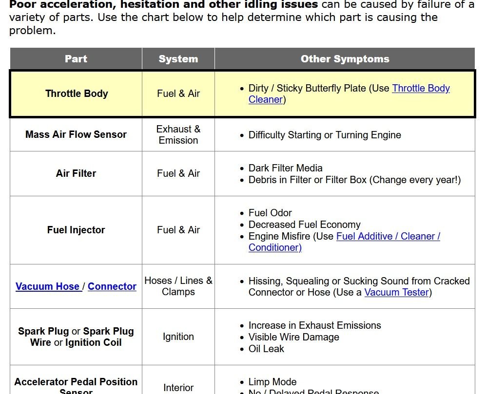

what is happening? should I remove throttle body an spray some throttle body cleaner inside?like this
an clean the mass air sensor to?
these tips I read from rockauto indicate something other than throttle body failing.this H2 has none of these simptums only idels an no throttle control control image
when I reconnect battery maybe I should be doing this relearn?
please advice an thanks

Loss of throttle control has nothing to do with the MAF.
Either you still have a wiring issue, The electronic portion of Throttle body could be faulty, or you have an issue with the sensor at the Pedal.
In order to Diagnose it and fix it properly you need a scan tool that is capable of showing Live data so you can see what is happening when you command it to open.
