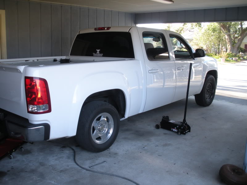

Plenty of people run a drag radial on oem rims. It's when you are trying to run a super wide tire on a narrow rim you get a ton of ballooning.
I ran a 275/55/16 m&h Drag Radial on an oem wheel with no issues.
Before i was 4/6 dropped
