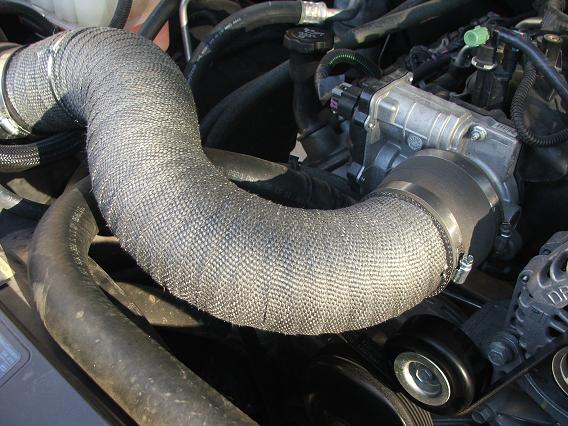

What was your 60' time and what kind of tires are you running?
Do you have any pics of your intake??

tires were slicks mounted on the obs stockers. can't recall the 60' i'll look it up in a lil bit. lemme get you a pic of the intake real quick. also I had 1/4 tank, no filter. no spare, no tailgate, no fatass buddy sittin next to me lol, and 93 gas.

this is an old pic. but that's still kinda what's on there. Right now I have some stainless lines that run around the k&n tube that I run liquid C02 through. the lines I put underneath the header wrap, and then on top I used some more fiberglass wrap to insulate it all. makes it a wee bit chilly . It's a big PITA to do and it's only just to see if it works. I spent probably 180 bux on the setup to do it right and I fabbed the pieces my self. the tank was a freebie (usually costs 150) from my old place of work. it drops the IAT about 30-50* instantly on a hot day. It's kinda illegal to have the bottle in the truck so I don't keep it in there haha. Nitrous is obviously a LOT more economical and cheaper in the long run, but being a nerd and having nothing to do on saturdays I gave it a shot. don't have any dyno numbers, but would like to get some. I have the IAT adder put in an extra 3* of WOT timing when the c02 is engaged.
btw, not sure if it causes condensation, it doesn't appear to though.
note: it's the 77 series tube that's metal. plastic tube wouldn't have worked too well
